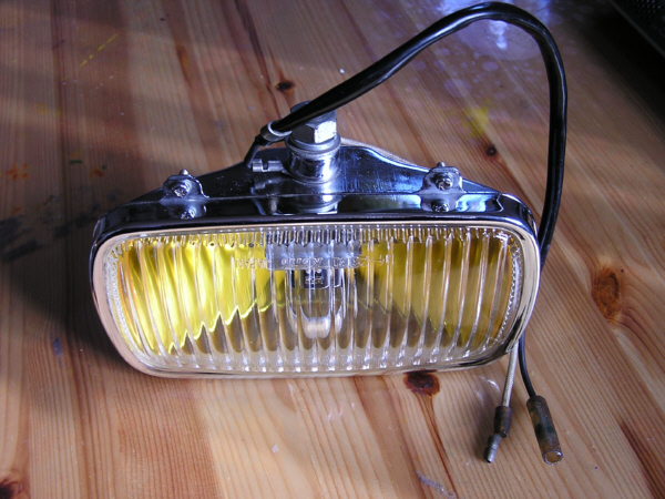

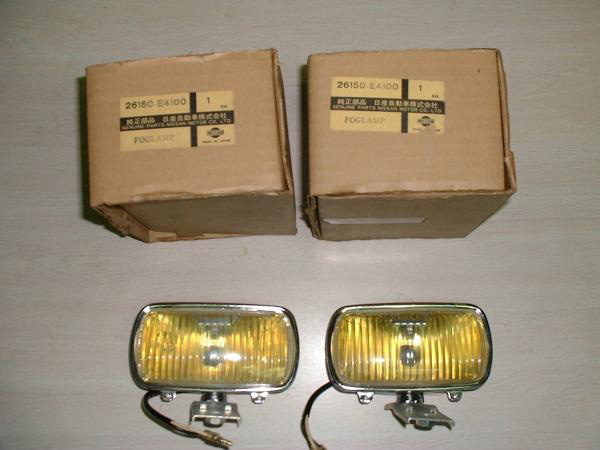

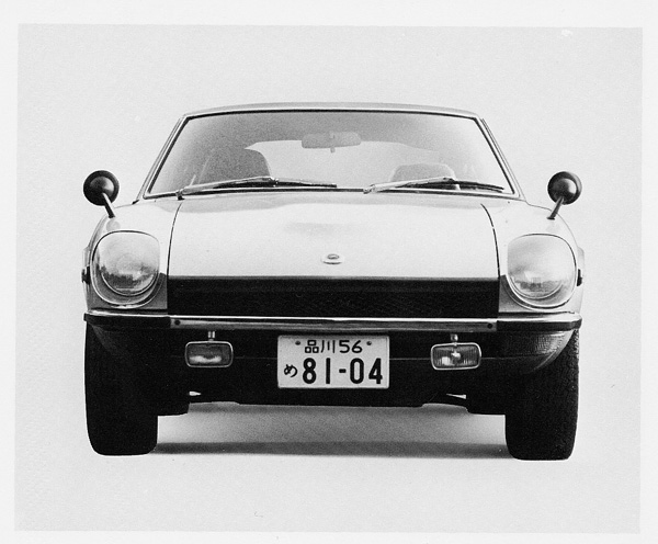

Perhaps a little off topic, but as an option, fog lamps for the S30 could be purchased from Datsun. The conversation is buried in the archives along with conversations about the switches, wiring.
Personally, I think the best way to break a fog lamp is mount it to the underside of the bumper.

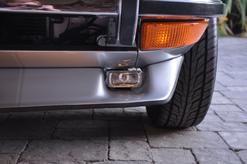

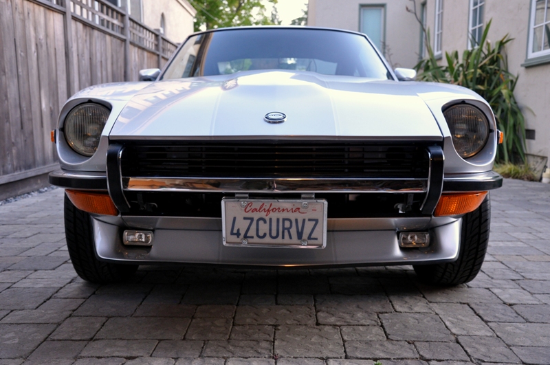

Here's where I installed mine. They are mostly for looks, but do provide some benefit in foggy conditions in lighting the road edge without blinding drivers coming the other direction.
They are basically H4 bulbs in a wide-angle lenses, so they are not super bright.

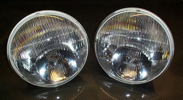

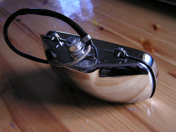

In 1970 I installed a set of CIBIE Biodes in my 70 Z. Wish I could buy a new set today...
They were among the first 7" round halogen replacements for the OEM headlights. They had two halogen H1 bulbs - one for the low beam that utilized the standard large reflector.. and one for the high beam that was inside it's own smaller reflector.. a projector beam more or less.
When the high beams were on, both H1's were on. Very directional lens and the high beams were amazing! You could see highway signs light up as the light from the projector beams hit them more than a half mile away at night.
When installed in the Z - you had to insulate the metal mounting taps on the back of the lights - otherwise they would short out to the body - and that would burn your engine wiring harness out!! The sealed beams that are OEM have glass mounting tab's on the back of the glass lens.... and as we know the ground for the headlighs runs through the wiring harness.
Picture courtesy of TRE Motorsports

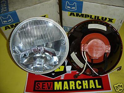

I'm with Carl. I'd love to have a pair of Biodes, or their Marchal equivilents—Ampliluxes. Very cool and great lighting. Ampliluxes were made in several variations, most of them were rather large and required bucket mods to accept them.
I can't recall when I last saw a pair of Biodes anywhere. Ampliluxes show up on eBay every now and then, but they tend to be $200 per pair and up.
