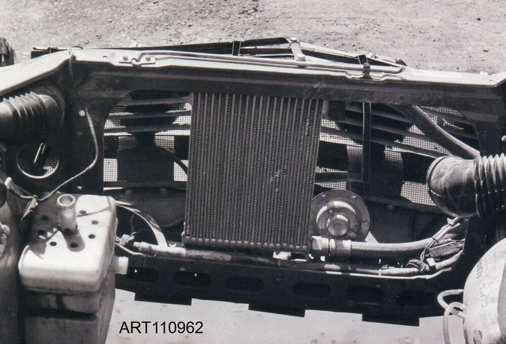

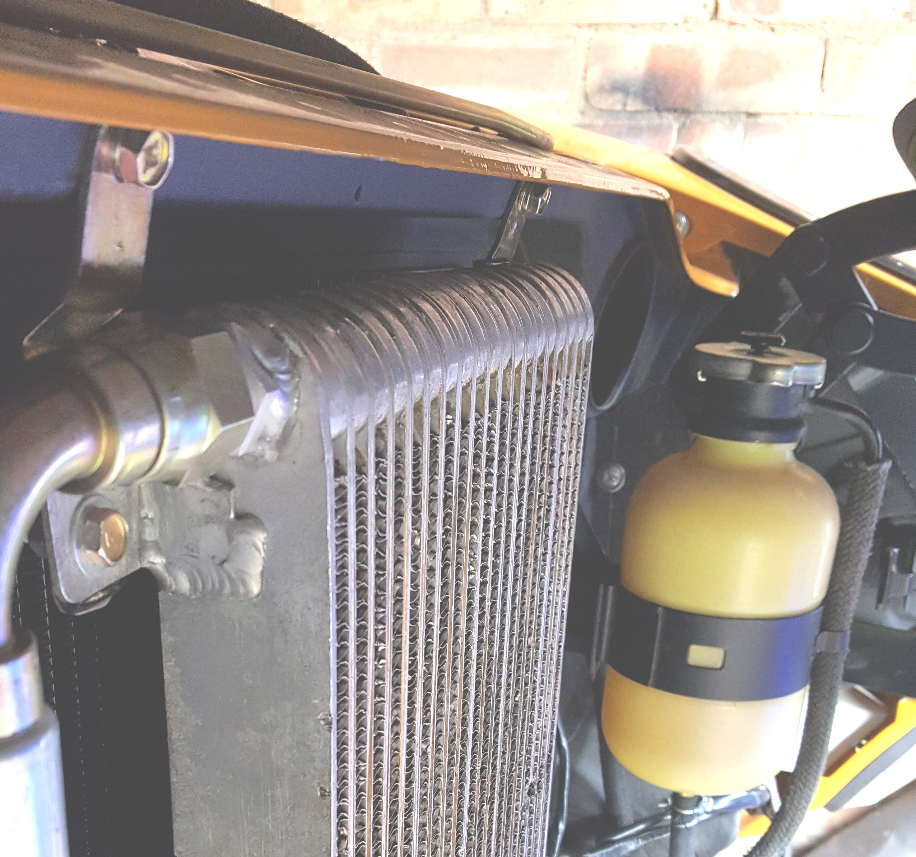

July 21, 20232 yr Author comment_655256 15 hours ago, HS30-H said: Yes, there were dedicated mount points in the radiator sore support panels. Top mounts required brackets between the (captive nut) mounts and the cooler and bottom mounts bolted straight through the core support. The top mounts have a certain amount of 'spring' built into them, which is most likely designed to give some vibration damping effect? Here's the cooler on my 432-R replica project car: Thanks Alan, I have never seen that pictures of works rally car before, very interesting! I count and would call it 18 version, the outer pieces on both sides are just a frame, no oil go through. And your Z432-R project car has also the 18 version! So what kind of car does 14 version fit in? Kats Link to comment https://www.classiczcars.com/forums/topic/23900-datsun-240z-vs-fairlady-z432/?&page=173#findComment-655256 Share on other sites More sharing options...
July 21, 20232 yr Author comment_655257 12 hours ago, 26th-Z said: A core is the galley by which the oil flows through. At first, I noticed a difference between the top brackets. One side mount and another top mount, as you show, Alan. But I see both side and top on the 18 core cooler, so... Hi Chris, I see it is interesting too, maybe for a quick replacements in a pit work? The one near the hose attached looks preventing the nut from being obscured. Kats Link to comment https://www.classiczcars.com/forums/topic/23900-datsun-240z-vs-fairlady-z432/?&page=173#findComment-655257 Share on other sites More sharing options...

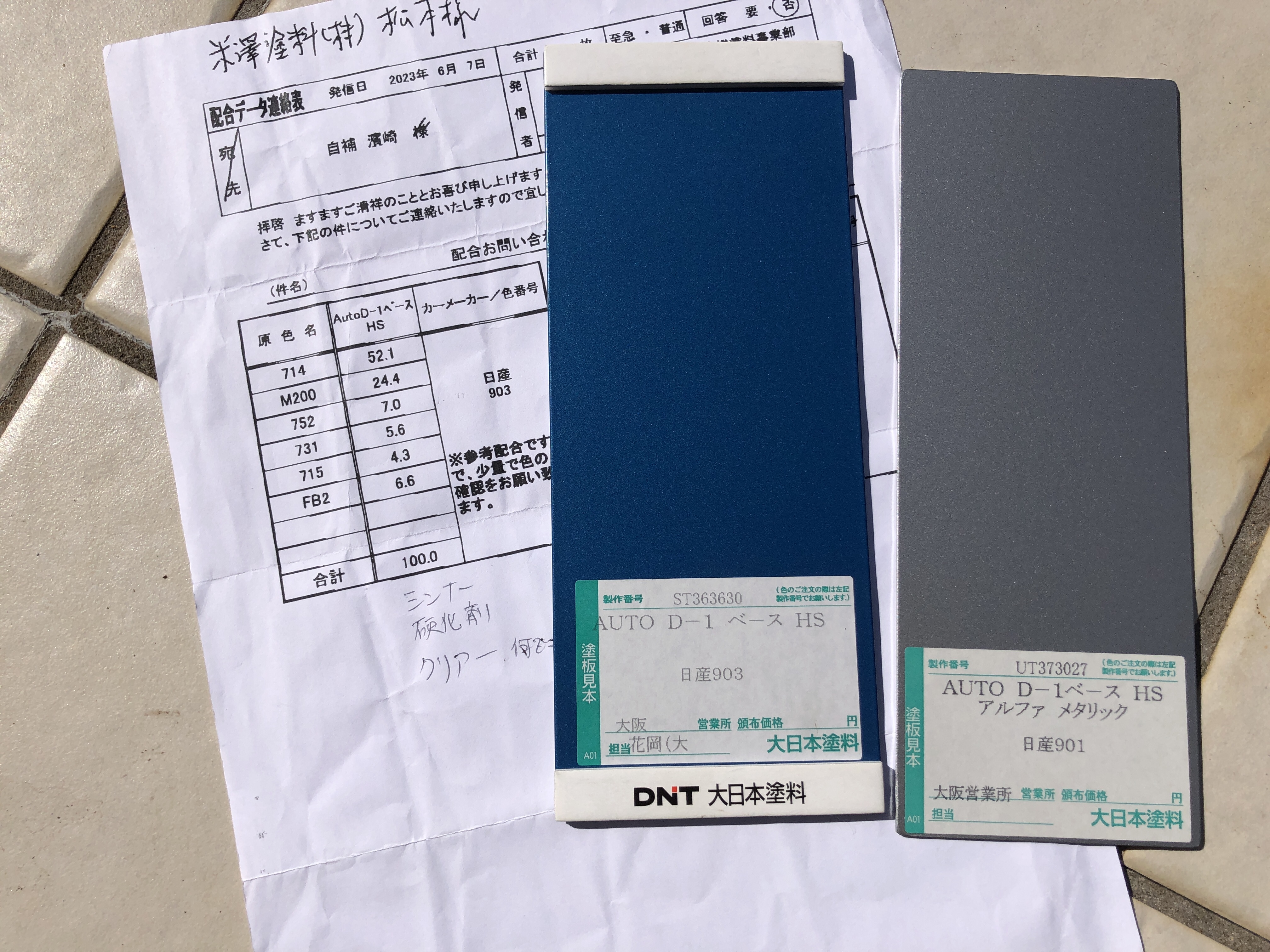

July 21, 20232 yr Author Popular Post comment_655260 I have been looking for original color for my blue 240Z, color “Universal Blue 903”. I finally got to know the manufacturer DAI NIPPON TORYO (DNT) and they made a sample for me for free of charge. We know Nissan used TANABE KAGAKU for the metallic paint, and there are mixing ratio of colors, this information can be seen only in Fairlady Z service manual. I have never came up to see those instructions in any other manuals. That means there is no information for Universal Blue 903 because it wasn’t available for Fairlady Z series. And seemed no Nissan domestic cars were sold in blue 903.(maybe I might be wrong). But I tried to ask a local paint shop which is very helpful for me and they found TANABE KAGAKU was merged into DNT. DNT replied they still have data of Nissan metallic 903 and 901 which they were originally provided by TANABE KAGAKU. Unfortunately, today’s paint isn’t the same like 1969 acrylic enamel paint. But I am happy that I think the paint has DNA of original 903/901. Please see the samples, I think it looks little bit lighter than my original 903 around the spare tire area, I have to decide to go with 903 or put a little bit arrange with this 903. Also, I really love 901 silver. I realized that my Z432 has much brighter silver, so back to 901 will be on my to-do list too. Kats Link to comment https://www.classiczcars.com/forums/topic/23900-datsun-240z-vs-fairlady-z432/?&page=173#findComment-655260 Share on other sites More sharing options...
July 21, 20232 yr comment_655266 That's super cool you were able to make that contact Kats! Link to comment https://www.classiczcars.com/forums/topic/23900-datsun-240z-vs-fairlady-z432/?&page=173#findComment-655266 Share on other sites More sharing options...

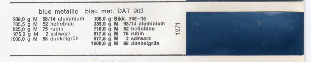

July 21, 20232 yr comment_655268 52 minutes ago, Patcon said: That's super cool you were able to make that contact Kats! Indeed! Great detective work, Kats. I don't know if it is of interest, but the old UK concessionaires 'Datsun UK' recommended Glasurit (German) brand paints for repairs back in the early 1970s. They quoted mix formulas for #903 Blue Metallic in both their 20 and 21 Line paint systems. I would imagine that they must have been quite a close match to the original Nissan paints at the time? Link to comment https://www.classiczcars.com/forums/topic/23900-datsun-240z-vs-fairlady-z432/?&page=173#findComment-655268 Share on other sites More sharing options...
July 21, 20232 yr comment_655288 8 hours ago, HS30-H said: Indeed! Great detective work, Kats. I don't know if it is of interest, but the old UK concessionaires 'Datsun UK' recommended Glasurit (German) brand paints for repairs back in the early 1970s. They quoted mix formulas for #903 Blue Metallic in both their 20 and 21 Line paint systems. I would imagine that they must have been quite a close match to the original Nissan paints at the time? That would be good info for the technical resource area. Glasurit paints are still available, as far as i know. Maybe people could add there paint formulas for factory color match and provide the specs for the paint they used Link to comment https://www.classiczcars.com/forums/topic/23900-datsun-240z-vs-fairlady-z432/?&page=173#findComment-655288 Share on other sites More sharing options...
July 22, 20232 yr Author comment_655303 Thanks Patcon and Alan, I didn’t know that, there was a paint manufacturer from Germany for our cars. And the paint samples! They must be so good, because it is German quality. Kats Link to comment https://www.classiczcars.com/forums/topic/23900-datsun-240z-vs-fairlady-z432/?&page=173#findComment-655303 Share on other sites More sharing options...

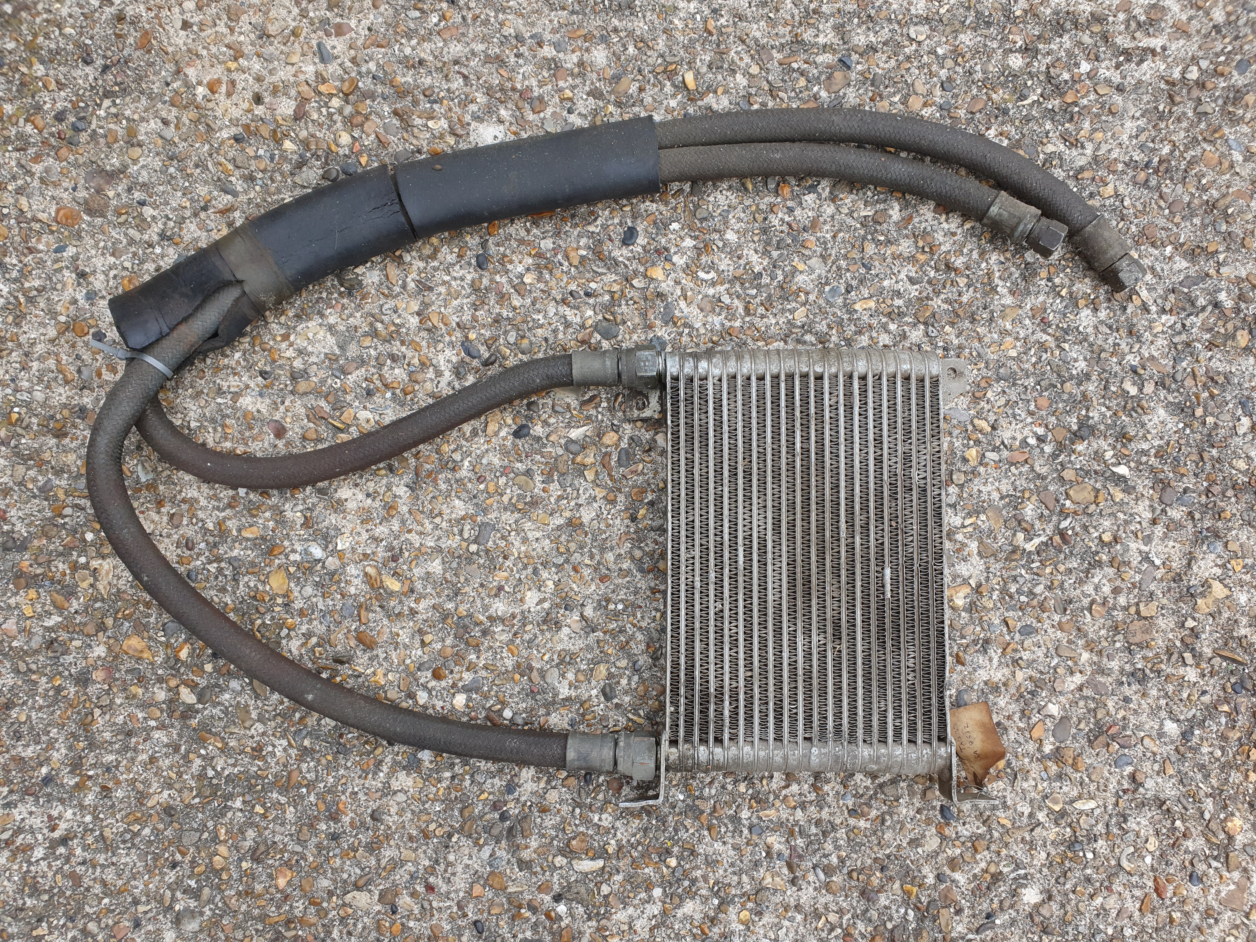

July 28, 20232 yr comment_655442 On 7/20/2023 at 10:37 AM, HS30-H said: I can't remember how many sections are on the two 432-R coolers I've got, but I'll count them. I also have a Works 240Z rally cooler and I count 19 sections (cores?). Here it is in period, still attached to the (heavily crashed) car that it came from, one of the 1973 Monte Carlo Rallye cars, built in 1972: To follow up on this, here's the above-pictured cooler as it survives today. 50 year gap between photos: Link to comment https://www.classiczcars.com/forums/topic/23900-datsun-240z-vs-fairlady-z432/?&page=173#findComment-655442 Share on other sites More sharing options...

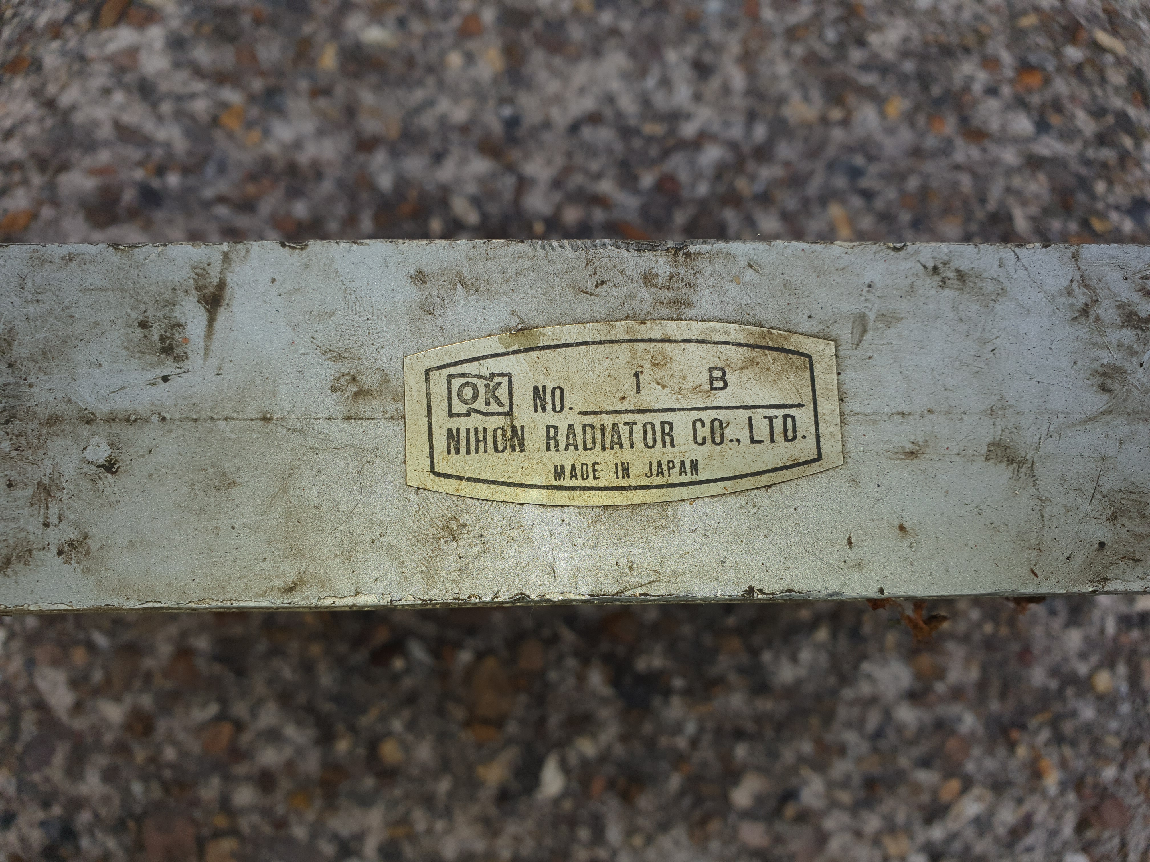

July 29, 20232 yr Author comment_655472 19 hours ago, HS30-H said: To follow up on this, here's the above-pictured cooler as it survives today. 50 year gap between photos: Thanks Alan, so you pulled it out from the works rally car, what a wonderful thing you have got! The small label shows February 1971, must be corresponding to the car’s manufacture date. I need to put the label on to my oil coolers! Kats Link to comment https://www.classiczcars.com/forums/topic/23900-datsun-240z-vs-fairlady-z432/?&page=173#findComment-655472 Share on other sites More sharing options...
