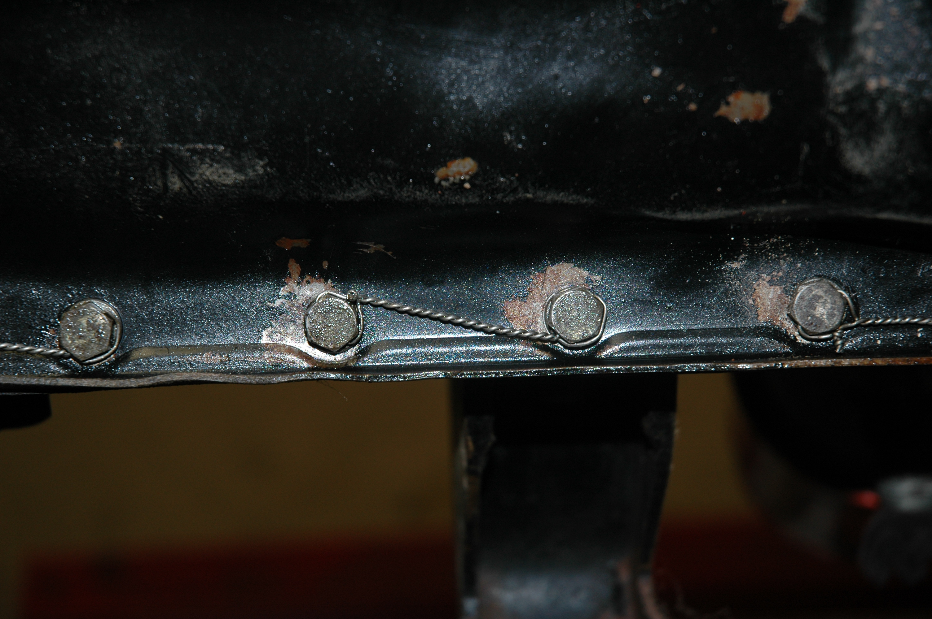

April 22, 20232 yr Author comment_652904 Hi, Alan and xs10shl or other people, can you find out what it is? A bolt for fixing the transmission case. The bolt’s head has a hole, I guess it should be used for a wire securing. But how I can do that? Two bolts adjacent each other should be tied? Or any other way? I have got this transmission yesterday, I made a gamble for this. The seller said this is Option 3, stand-by duty for a racing team. And he heard it came from Speed Shop KUBO, really? I rotated the rear end flange to see how much turn does the input shaft make. The seller and I confirmed it is close to the Option 3 ratio. Without any internal pictures, but I jumped in. I am scared to open the case, let’s see what I will have. Kats Link to comment https://www.classiczcars.com/forums/topic/23900-datsun-240z-vs-fairlady-z432/?&page=171#findComment-652904 Share on other sites More sharing options...
April 23, 20232 yr comment_652905 Yes, typically they are wired to each other Sometimes they are all wired in series. I don't know if the bolts are available already drilled. I know many times racers will drill them themselves to make safety wiring possible. I don't know historically but many modern racing classes require some level of safety wiring Link to comment https://www.classiczcars.com/forums/topic/23900-datsun-240z-vs-fairlady-z432/?&page=171#findComment-652905 Share on other sites More sharing options...
April 23, 20232 yr comment_652908 Looks like a nice purchase. What A-box ratios are option 3? My rally car has option 1 (Mid-Close), and I'm aware of option 2 (Ultra-Close) from my reading materials. Sounds like there are more ratio options? Patcon's picture is a good illustration as to how they'd be wired together. I don't know that the bolts were drilled that way from the factory, but one can probably purchase them that way from a vendor. Link to comment https://www.classiczcars.com/forums/topic/23900-datsun-240z-vs-fairlady-z432/?&page=171#findComment-652908 Share on other sites More sharing options...

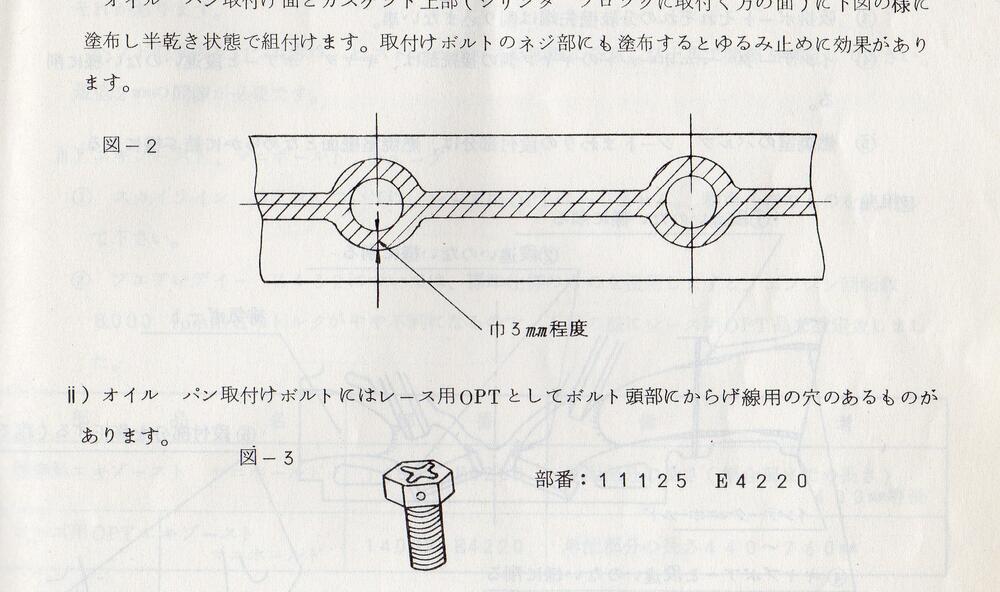

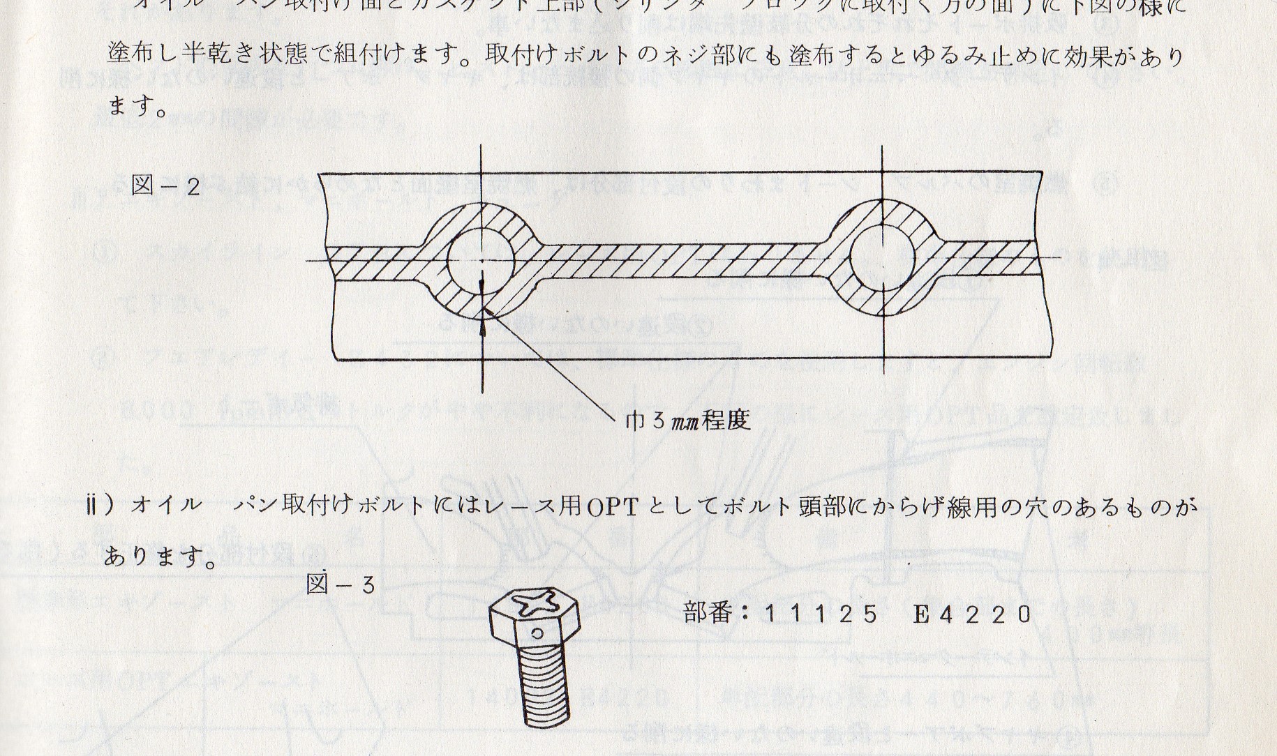

April 23, 20232 yr comment_652912 7 hours ago, kats said: A bolt for fixing the transmission case. The bolt’s head has a hole, I guess it should be used for a wire securing. But how I can do that? Two bolts adjacent each other should be tied? Or any other way? I have got this transmission yesterday, I made a gamble for this. The seller said this is Option 3, stand-by duty for a racing team. And he heard it came from Speed Shop KUBO, really? That's a nice purchase, Kats. I am jealous! Quite possible it did indeed come from SS KUBO. Kubo san acquired many parts from Tomei, Scuderia Nissan and the Works team over the years he was involved in racing and afterwards. He picked up a lot of rare parts. There's a small mention of lockwiring in the first Nissan Sports 'Yellow Book' from 1970. This was for the oil pan bolts, but - as Patcon mentions - this was common in aviation and specialist machinery preparation since the beginning of the industrial revolution (I've seen it used on steam pumps from the early 1800s...). Typically the bolts are locked against each other to stop loosening from vibration. Here's an example from a Works rally L24: Link to comment https://www.classiczcars.com/forums/topic/23900-datsun-240z-vs-fairlady-z432/?&page=171#findComment-652912 Share on other sites More sharing options...
April 24, 20232 yr Author comment_652939 On 4/23/2023 at 10:03 AM, Patcon said: Yes, typically they are wired to each other Sometimes they are all wired in series. I don't know if the bolts are available already drilled. I know many times racers will drill them themselves to make safety wiring possible. I don't know historically but many modern racing classes require some level of safety wiring Thank you so much Patcon, The one in the picture all wired in series is super! I have never seen like that before. I want to do it beautifully, use a drill to twist wires? Kats Link to comment https://www.classiczcars.com/forums/topic/23900-datsun-240z-vs-fairlady-z432/?&page=171#findComment-652939 Share on other sites More sharing options...
April 24, 20232 yr comment_652941 23 minutes ago, kats said: Thank you so much Patcon, The one in the picture all wired in series is super! I have never seen like that before. I want to do it beautifully, use a drill to twist wires? Kats I think they make a special set of pliers to do it... I couldn't paste in an image... Google "safety wire pliers aviation" Edited April 24, 20232 yr by Patcon Link to comment https://www.classiczcars.com/forums/topic/23900-datsun-240z-vs-fairlady-z432/?&page=171#findComment-652941 Share on other sites More sharing options...

April 24, 20232 yr Author comment_652955 Thank you so much Alan, I have been looking for the picture of wiring of the bolts for our engines, just fantastic! I think oil pan bolts can’t accept much torque so wiring is a good backup for securing. And thanks for educating me about engineering back ground. Now I am interested in how did mechanics do for their military airplanes and ships WW2 etc. Please stand by for further details, I will be so happy if all the gears are intact and have correct number of teeth as Option 2 gears. If not, I will still be happy because it is FS5C71A anyway! And I can dream about Kubo san’s relationship with this one. Kats Link to comment https://www.classiczcars.com/forums/topic/23900-datsun-240z-vs-fairlady-z432/?&page=171#findComment-652955 Share on other sites More sharing options...
