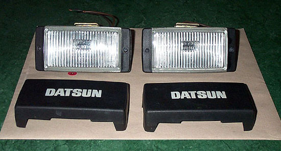

I was (and still am) looking for these when I bought the ones I would sell. Chloe (remember her?) e-mailed me with a zcar.com ad and I bought them sight unseen. I think they are for the 280Z as a Datsun option. They are in pretty good shape but I do not know if the bulbs work. Metal and plastic housings. Glass lens. Plastic slip-on caps. I recall one of the caps has a scratch.

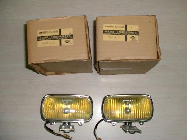

Does anyone have a good picture of the stock lights that are listed in my factory wiring diagram and is switched at the choke plate area. I can't say I have ever seen how this was done. I believe/ or led to believe this was a option on the overseas cars.

I think the lights that switch there are actually running lights that are individually switched(L or R side) for safety in pulling off the road, several threads have discussed this, and the fog light switch was actually on the dash in what lookes like a conventional cigarette lighter position. I'll try to find a thread and post it for you.

The early cars in other parts of the world could have fog lights as an option, but they were never offered on 240Zs here in the states. Escanlon (in Vancouver, WA) has one of the factory fog light switches, I believe. It went in the empty hole above the hazard switch on the early dashes.
