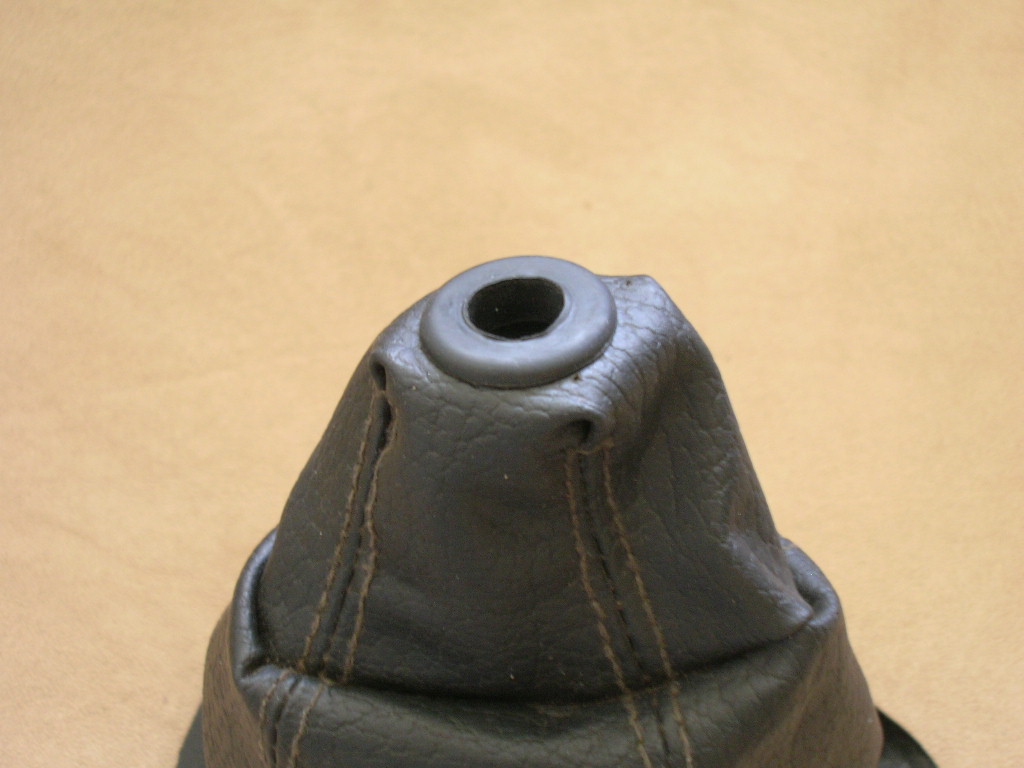

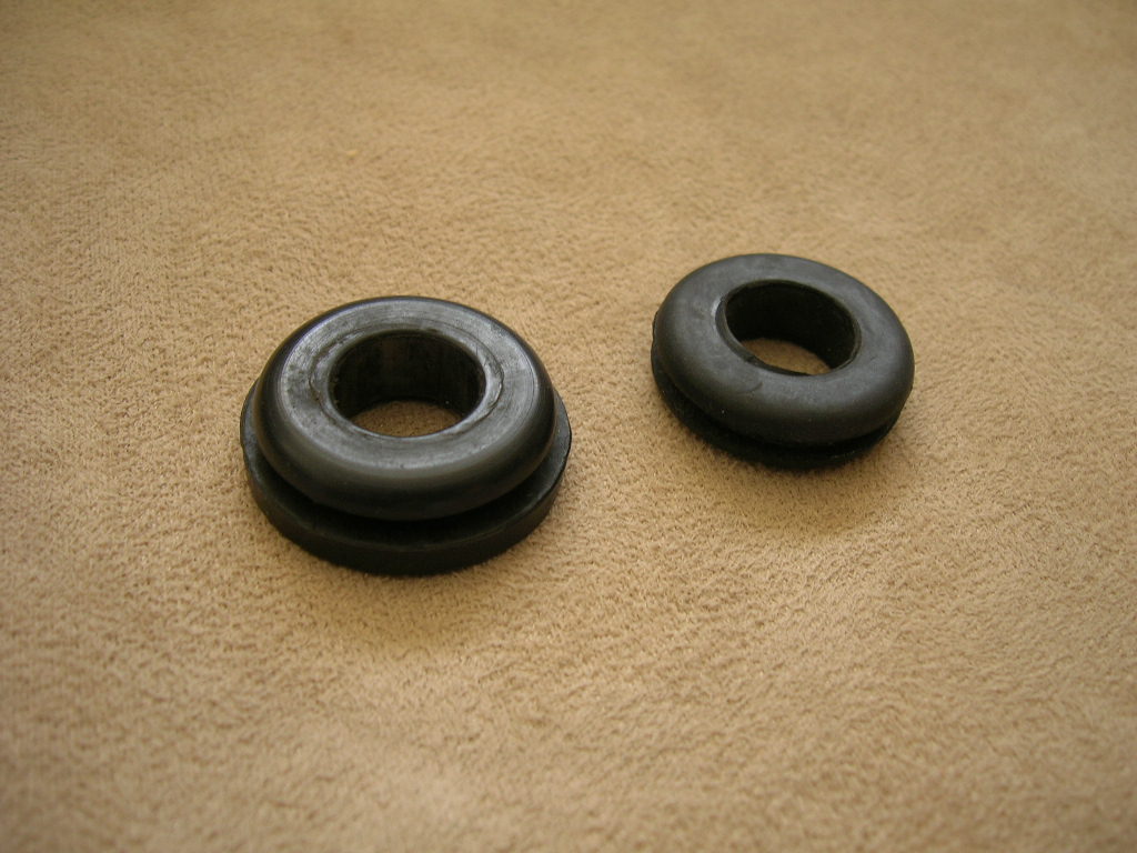

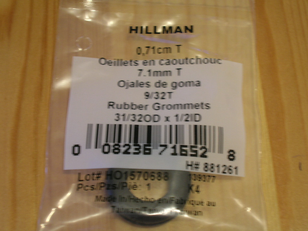

Few months ago, I found a very close thing to an original shift gromet at a local store. So I will share that info with everyone here. You can buy these at Home Depot, Lowes, and other major hardware store. See the picture. It is exactly the same design, shape, and size from outside. Spec is 0.71 CM (9/32 ODx 1/2 ID) Only difference is that bottom part is larger on the original one. So solution is to put another piece of the material(punched as to part) put it over from back side, so it will not slip off. It costs from $1.75-$2 range.
Original material is a hard rubber, and this one seems slightly soft. But it appears the same.
I know some of the members are looking for this for a long period of time.

Excellent info. I figured there must be a suitable alternative out there somewhere. While I'm happy that I still have my original grommet, if I needed one this looks like it would do just fine.
I hit Lowes and found it, and I have one from Bryan. I agree with you Bryan, yours looks and feels closer-but under the boot either will do the trick!
