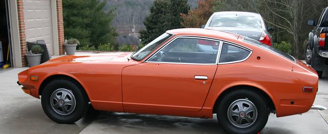

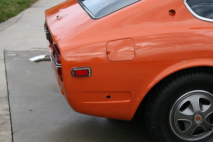

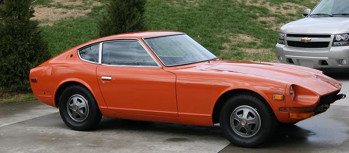

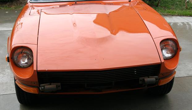

Here are the before and after shots of the car, so if something sticks out that I didnt remove let me know.

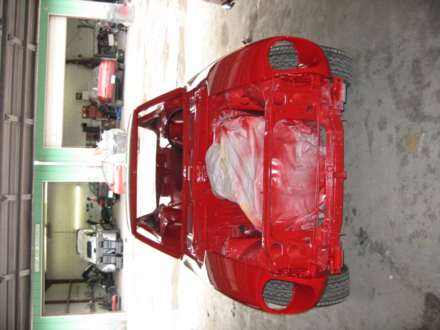

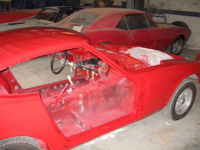

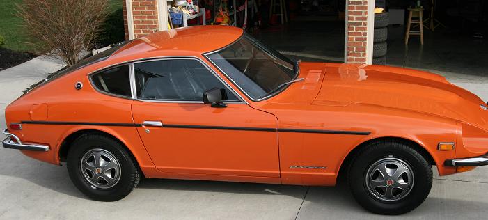

I removed everything. I was trying to get rid of the rust, floor pans, all quarter panels and runners. Here is a pic of how it looked after paint. My paint and body cost only $2500., but took over a year. They were doing it while not busy on insurance cars
