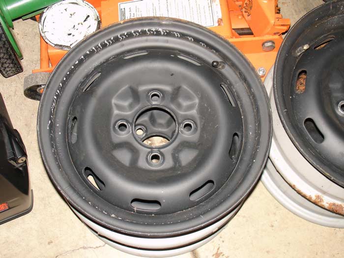

Yup. Here are pictures of mine.

I may well be color blind - but the wheels you have pictured, aren't flat black as far as I can see. Charcoal Gray...perhaps.
I've always felt that the wheels were sprayed with the same charcoal gray that was used on the rear tail light finisher and the grill. Because of the underlying colors there is ever so slight a difference in the finished product...
If you call Les... I'm pretty sure he'll say the same thing. He sells that OEM Charcoal Gray in a rattle can..
I suppose that if you sprayed a very very thin coat of flat black over a silver wheel - it might come close to a charcoal gray finish...

Never having met you in person Carl, I can't speak to whether you are colorblind or not, but the camera flash definitely lightened the appearance in the picture. Trust me, they are flat black, not the charcoal of the grill and finishers. The wheels I have are dated 4-71, and were removed from their original car less than a week after first delivery. They came to me out of the first owner's attic still with the original Japanese wheel weights attached. Obviously never been painted or otherwise mucked with. And Rustoleum Rust Reformer in Flat Black is indistinguishable from the factory flat black finish.

No, you said that 3 months ago, not years ago. :) No problems either way. Please do let me know what color yours are.
I looked at my original wheels-all flat black-both sides!
