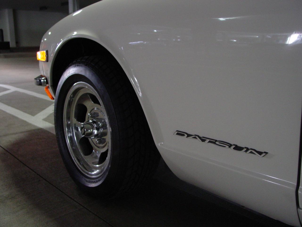

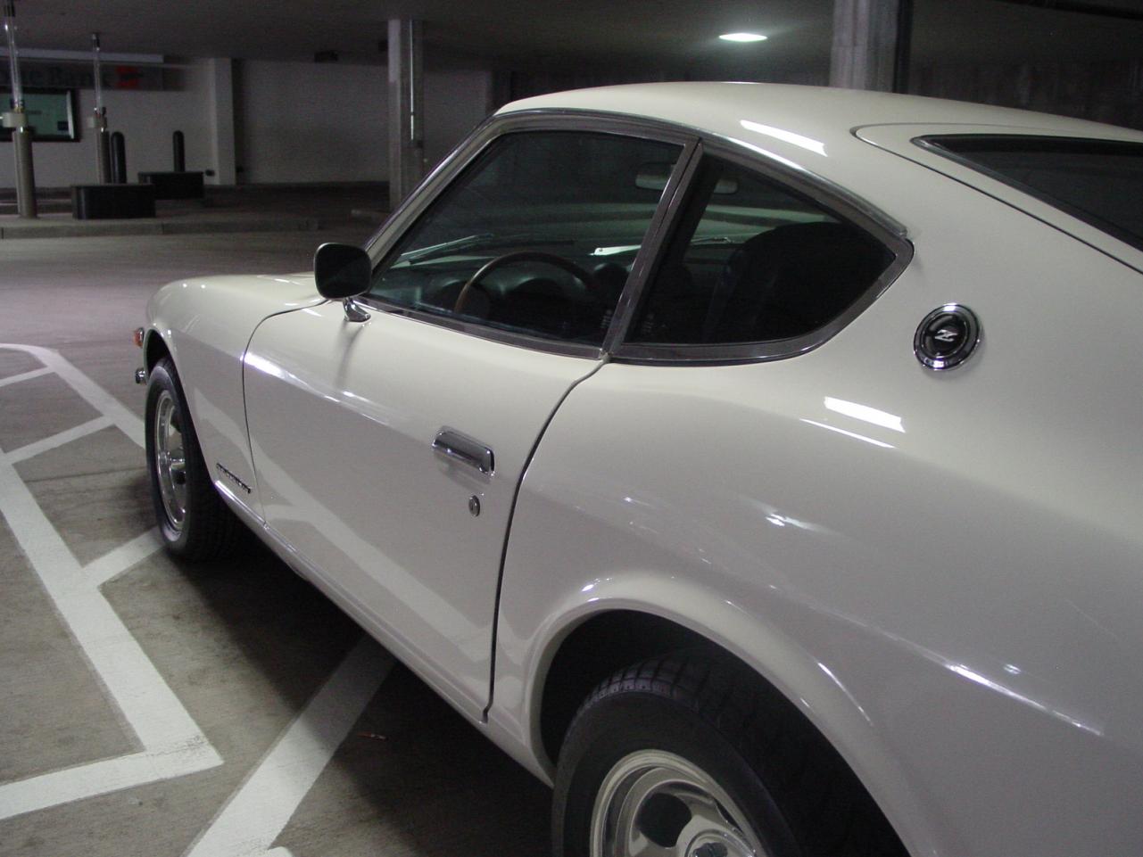

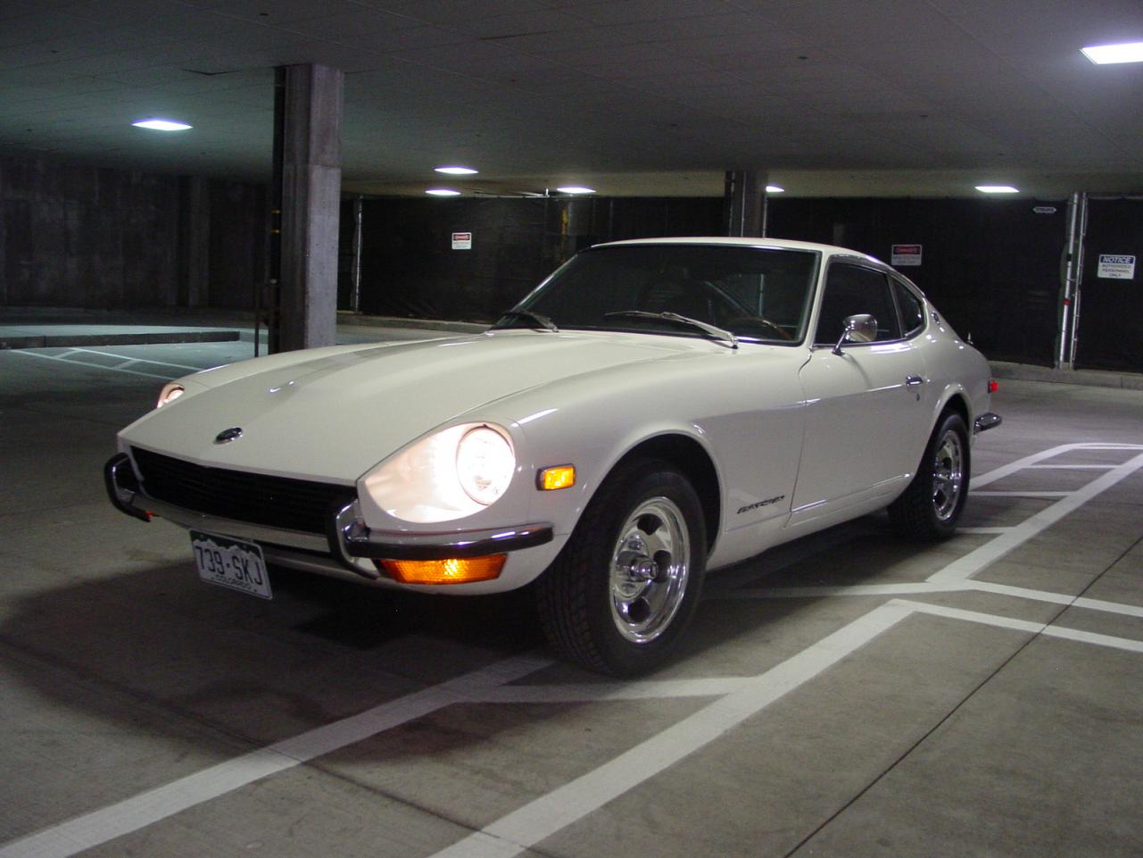

My body & paint guy, Karl Witchie used a single-stage process using DuPont urethane paint that closely matched the original 904 White on the '72 (below). On my '71 from Arizona, he used the same process. (I plan to have him deliver the '71 very soon so I can get started on the interior and everything else).
Wow, looks great Steve! Thanks for the pictures. I've probably got a month or two before I need to decide. I'm sure that with modern paint technology either way would be fine. When I had my blue car painted last year it was using base and clear, which was correct for the car since it's a metallic color, so it was an easy decision.
-Mike
