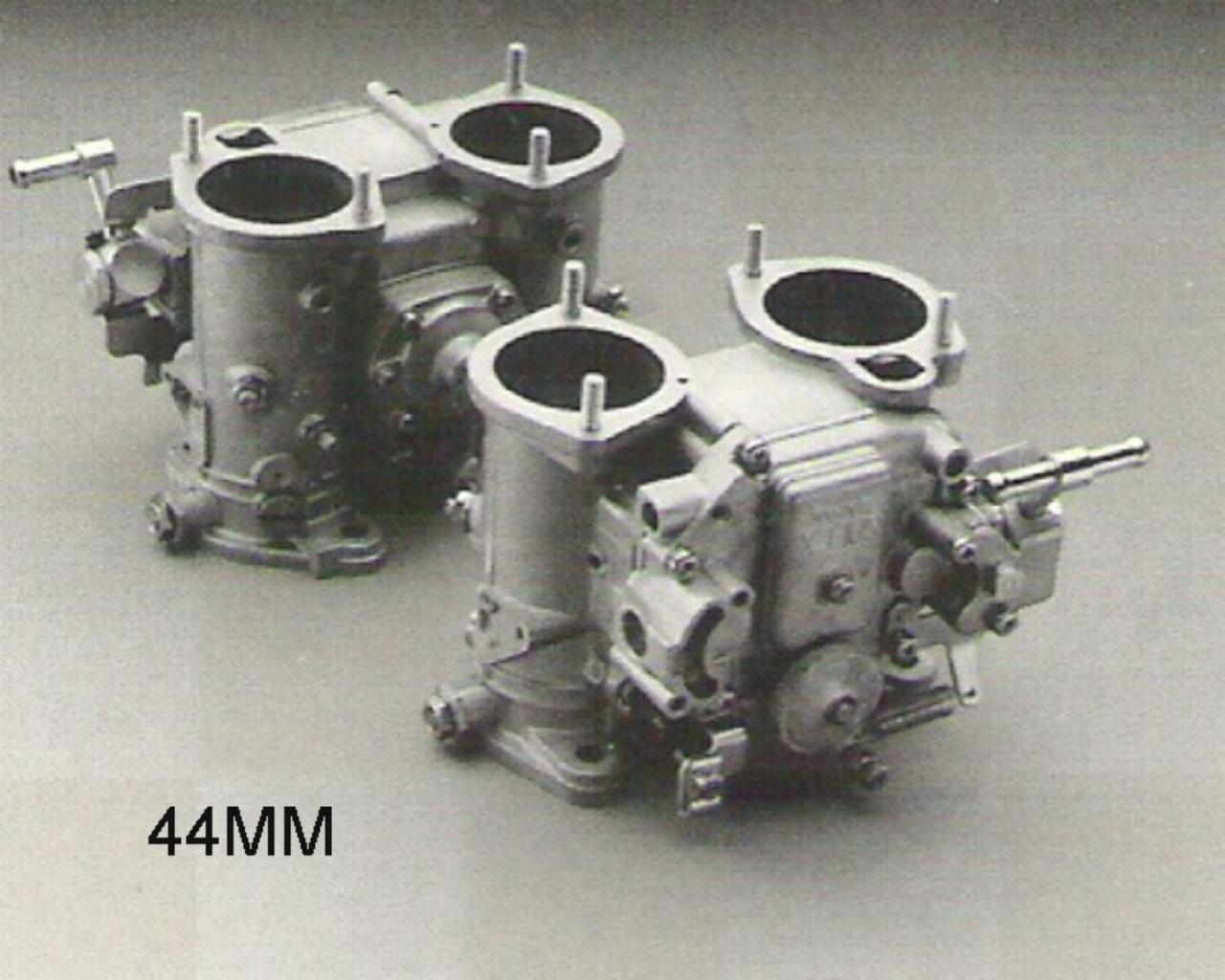

The opening on a 44mm Mikuni is 48mm I seem to recall. The opening on the manifold side is 44mm. If someone were to measure the air horn side it would be pretty easy to mistake 44s for 50s
According to a recent post on Hybrid Z, you should be able to look at the butterflies and tell what it is. 40's will have 165 stamped on them, 44's will say 175. No idea what 50's would say...

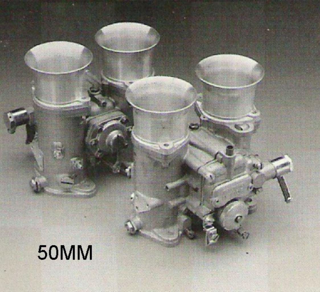

Checked with my "Mikuni Guru" this morning. He got his set of 50's off the shelf and checked for me. 50PHH's have "180" stamped on the butterflies.

Except for the ones for the 4 cyl. which has "185" stamped on the butterflies.
Mikuni 50's only come in the "old style" dual screw jet cover configuration and the bodies of these carbs are made of magnesium. They look completely different...and are not what is pictured above. I have a set of tripple 50's and will look for stampings on them if you wish, but a cursory glance will tell you if you have 50's. In this case these are not 50's.
The carbs in the photo by Brushie are 40's or 44's (since they both look the same).
To be sure measure the back or bottom of the bore diameter (in millimeters) that will give you the correct size of these carbs.
