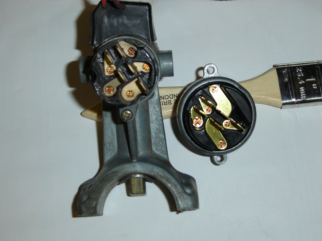

Here's a picture of the one that came on my 1970 and a new one I got from VB. Obviously the mounting holes are different but the spade connection pattern appears to be the same.
I'm not sure where you can get a new ignition switch for the early 240 ignition. You may have to buy a new ignition for your car.
Bruce
Hi Bruce, looks like you have the same setup as I do, and that the new VB one you puchased is also too big to slide into the your bracket. I measure roughly 1.33" OD for the new switch where it slides into the bracket, vs 1.18" for the old one. The connectors are also the same between my two units, but that doesn't do me too much good considering the part itself is much too big to fit.
I just wanted to confirm my car's setup was not unique, as the sales rep at Motorsport was basically telling me I didn't know what I was talking about because Nissan's application list must be correct for all years 1970-1983. Makes me mad I'll have to pay $40 for someone else's mistake.

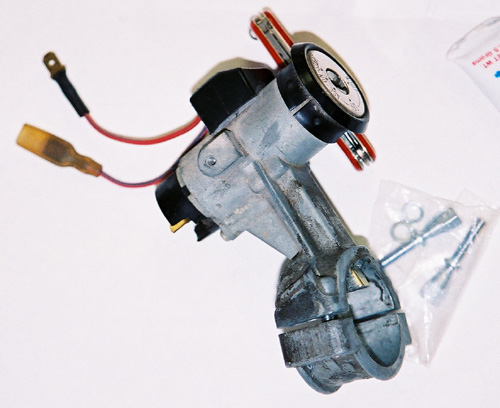

Depending on your date of manufacture, you may have an ignition switch that looks like this. The terminals are different from the upgrade part, however everything plugs into the harness the same. I would have to look it up, but this early switch was upgraded and the barrel is indeed a different size. You can't replace the guts of these anymore. You have to get the whole bracket.
You might try some of the Datsun Roadster parts houses-looks the same to me...but I don't have one to measure against.
Will
