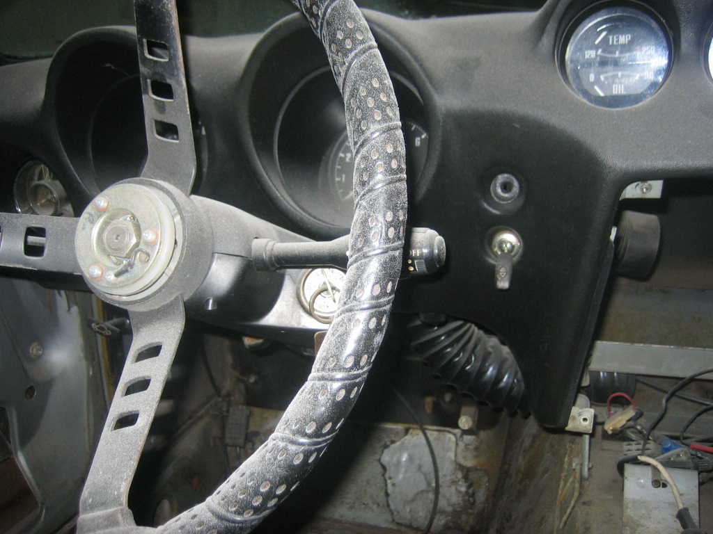

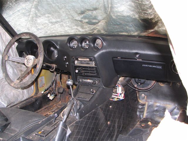

This pic is from a 10/70 240Z that I purchased as a parts car with the help of beandip (Gary). :)
It has two of the toggle style switches mounted in this area of the dash you are discussing. The car appears to be original except for the wheel and seat which are just replacements for transport----
I am pretty sure that the lower toggle is for the emergency flashers and is correct as it should be.
I wonder if the upper toggle switch is for foglights, as you describe them Arne. It does have the blanking plate in the center console next to the choke indictor light, which is where some have said the optional parking lamp switches would normally be located.

Arne is spot on, and Jim's car has second Hazard toggle in that location (if memory serves as to what I saw).
That indent was to be used for the Fog Lamp Switch, which was an OEM JDM option tht was never brought into the U.S. (At least no pictures or switches have been located in the U.S. yet.).
Even in Japan it was a rare option.
The Fog Lamp switch has a toggle identical to the Hazard Lamp Toggle, but a different emblem on it. and connects directly to the Fog Lamp circuitry that is built in to the car's wiring harness (With an in-line fuse holder).
The "optional" parking lamps and their switch-pair were a JDM option not brought to the U.S., but may have also been sent to countries with a requirement to illuminate the traffic side of the vehicle at night.
This has been discussed and verified before.
