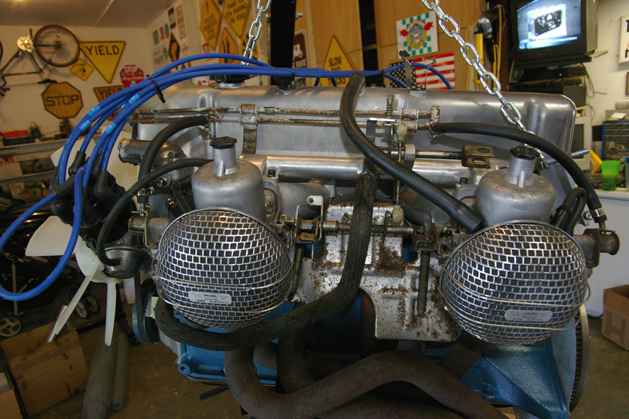

My car has the round Weiand air cleaners on it. I was able to find new elements (Longflo) for them at http://www.victoriabritish.com/icatalog/t6/0026.html
They fit perfectly.
The Black Dragon catalog only shows the oval ones.
Todd
dzrt1st - Very cool! I have the oval ones, but those look like what I need! Thanks sooo much!

The looks of the Weland air cleaners - cost you performance. They do not have enough room for the air horns that the SU's need for proper operation. You are far better off with the stock air cleaner, which does have the air horns built into the base.
