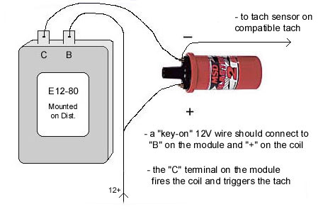

There are two connectors on the 'Black box' on the side of the ZX dizzy. They look like this |- . I bought a reman model from Autozone and it does not label them as B or C as is supposedly shown on the E-12-80 module.
I have seen two wiring diagrams, one on jrdremers and the other on the technical section here. My set up will be the same as the tech article complete with the MSD connections. However, they don't agree.
Tech article link http://www.classiczcars.com/forums/showthread.php?t=13085&highlight=distributor
Could someone please tell me if the 'top of the T' or the 'stem of the T' is the B connection?
Thanks,
Whoa there SavannahZ....that set up won't work with a 240 tach NOR with the MSD coil. There's a notice within that article that spells it out:
A 240 tach may not work with this setup since it's inductive pickup can no longer connect to the coil. Replace it with a 75-78 280Z tach and connect the tach sensor lug to the - terminal on the IC module. If the tach jumps around, solder a 7500-10,000 ohm resistor inline with the sensor wire to reduce the signal voltage. If it still won't work buy a Autometer #3990 black face tach.
WARNING: if you have a MSD or Crane, DON'T hookup the module or tach directly to the coil. The 450 volts can fry it. Follow the ignition's hookup guide.
The Tech Article you posted Zack, has the correct connections for a 240 Tach and the MSD.

I didn't realize he had the MSD setup. However, atleast with my setup, the tach works fine following the diagram I posted. Hopefully, he can see what the connections are labeled as...which was my intention in the first place.

But aside from that, the problem with ZGarage's diagram is that it is SPECIFIC to the One Wire Sensor Tach (280) and will not work at all with the 240 Tach (Coil Loop Sensor). This has been presented several times before and that distinction is something that needs to be noted as it causes problems time and time again.
