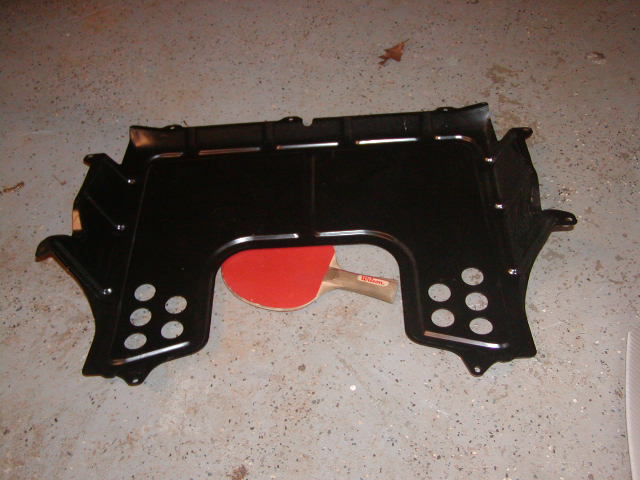

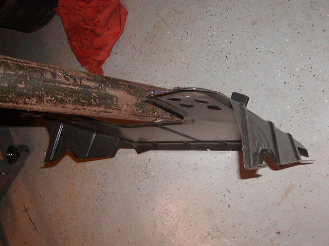

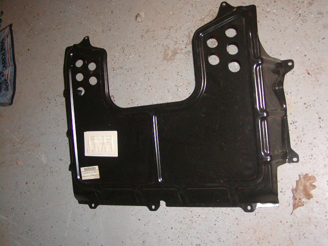

I bought one of those pans a while back from Nissan Motosport for my C Production 240Z race car. They said they were NLA for 240Zs, so I went ahead and ordered one for a 260/280Z with the hope I could modify it to fit. They said I'd purchased the last new one available through Nissan in the country.
Long story short, I had to bend it up on the front edge to fit my car. I tried it out at California Speedway, where in the past my front end got so light through turns 1 and 2 that I could steer the car with one finger. Now with the increased downforce, I need two fingers to steer the car through those turns.

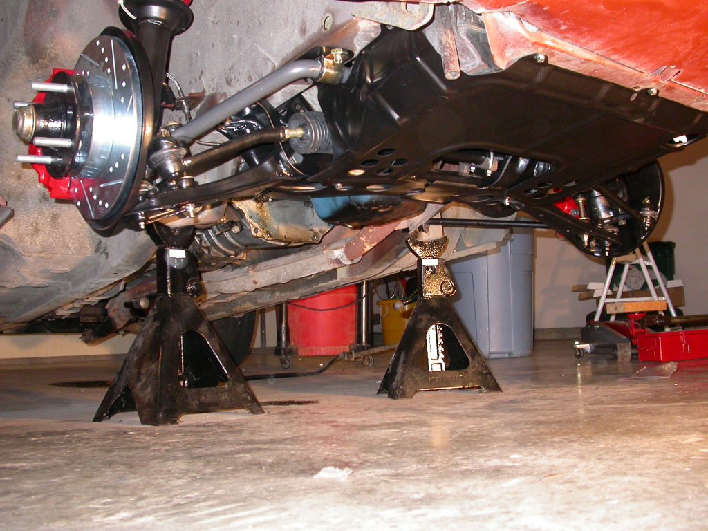

Here's the belly pan installed on my '78 280Z (original - wirebrushed and repainted) after my suspension rebuild. You can see the big cutout for the radiator drain that doesn't appear to be in the 240Z pans.
