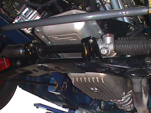

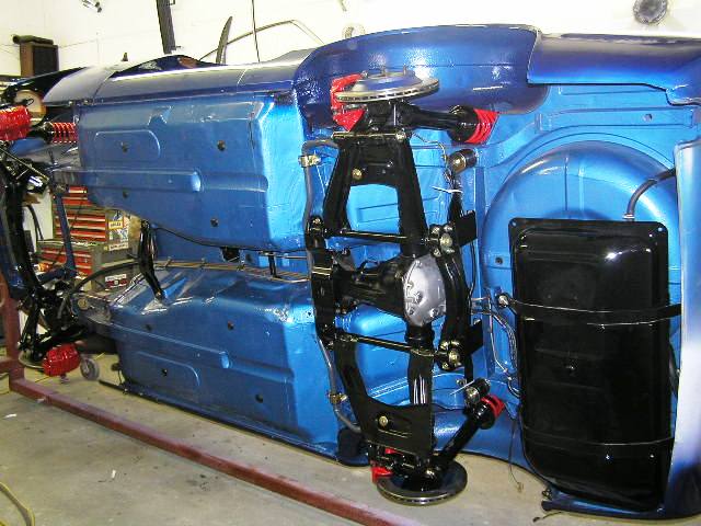

Thanks for the advice. As you can see from the pics, my Z is clean underneath. I have changed the 0-ring in the gear housing and the cable seal. I got these items from Nissan. It still leaks. I am stumped! Why does this cable still leak?
Look close at the cable housing, cable and o ring are they smooth and free of mold marks? I had a slight crack in a brand new cable that drove me nuts. What do we say in the industry just because it is new does not mean it is right. If they all look good then I would change the o ring again.
MAN! you weren't kiddin. only one other zed that i know is that clean and it's ed's zed.
