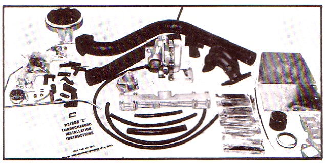

CROWN Mfg. was one of the first to put a Turbo on the Z.. they used the one S.U. in their set-up. As I recall that was around 74 or 75.
<a href=http://zhome.com/picturelibrary/turbol24.jpg TARGET=NEW> See Picture Here</A>

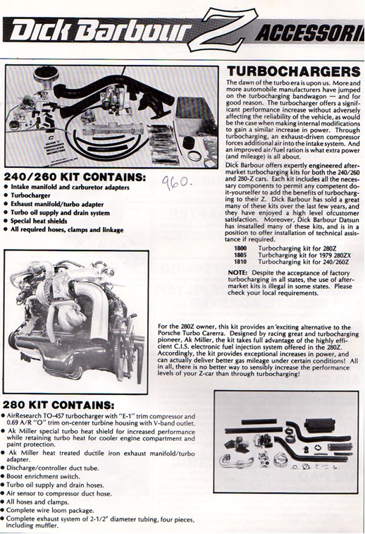

Ed,
In going through my literature, the pieces in the auction seem to be part of a kit sold by **** Barbour Parts and Accessories For Datsun Z.
Check out the attatched scan from their catalog, some of the pieces pictured are dead ringers.
Will

About a year or so ago, at my friend's shop in Upland, Ca., there was a wrecked 75 or 76 280Z with the 280Z kit in the attachment. I remember discussing it with him. It was complete but the turbo itself was siezed up.

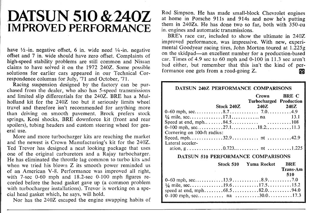

Well.. looks like my memory isn't too good... Here's a comparison in April 72 Road & Track... on the Crown Turbo vs. Stock vs. the BRE C-Production Z.
