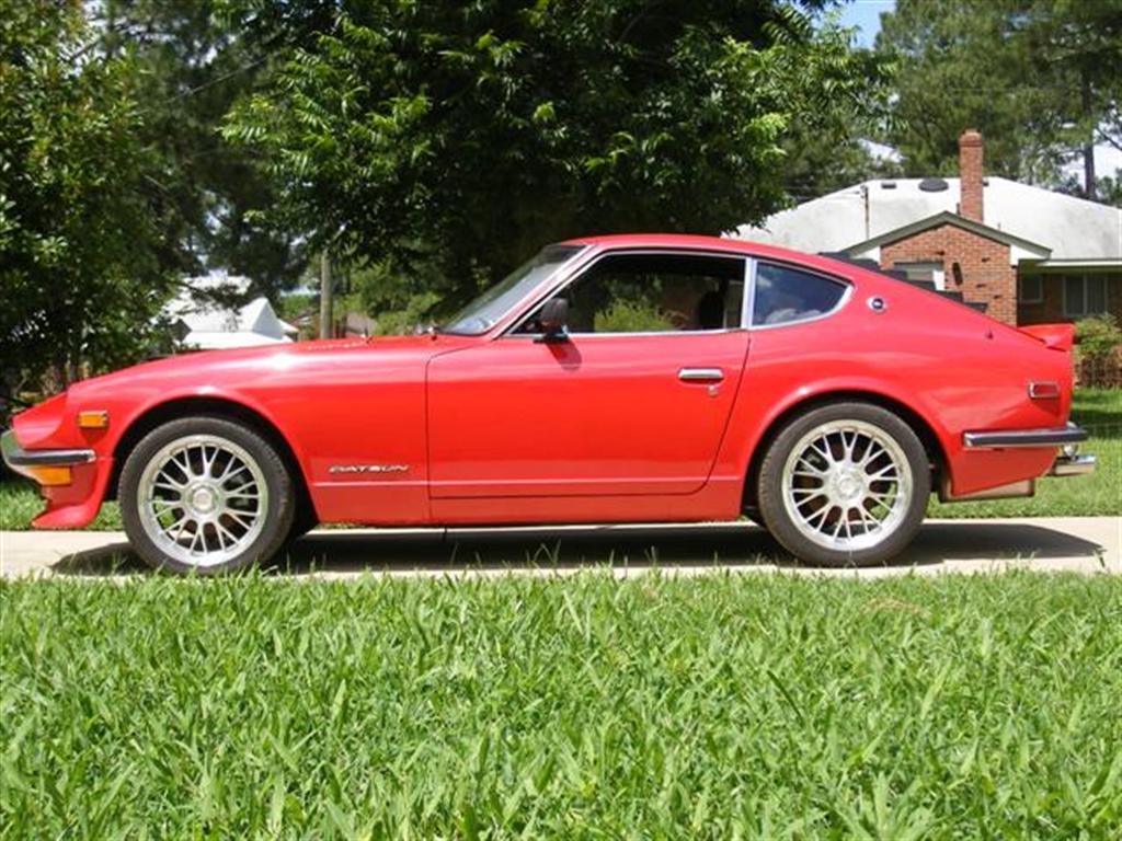

I had a MSA setup but opted to go stainless all the way out the back. I ended up using a Janspeed header, Verocious Motorsports pipe and Magnaflow mufflers to build the system. I'm waiting on my Ztherapy SU's to arrive this week but I must say the exhaust has a deep growl with no raspiness (at least sitting in the driveway) using triple Dellorto's or the old SU's. My exhaust is tucked very nicely although the resonator does hang just a little low. It should not pose a problem though, even over speed bumps. My muffler is exposed from the side profile but not obnoxiously so. It could have been tucked up tighter however I felt the heat generated would be more readily transmitted to the interior that way. You can see pics viewing post #17 and #18 at the following forum, http://forums.hybridz.org/showthread.php?t=103301. Although this is not MSA related persay you can see that a proper exhaust can be installed in your garage. I have no reason to think that the MSA system couldn't be massaged to fit better too.
