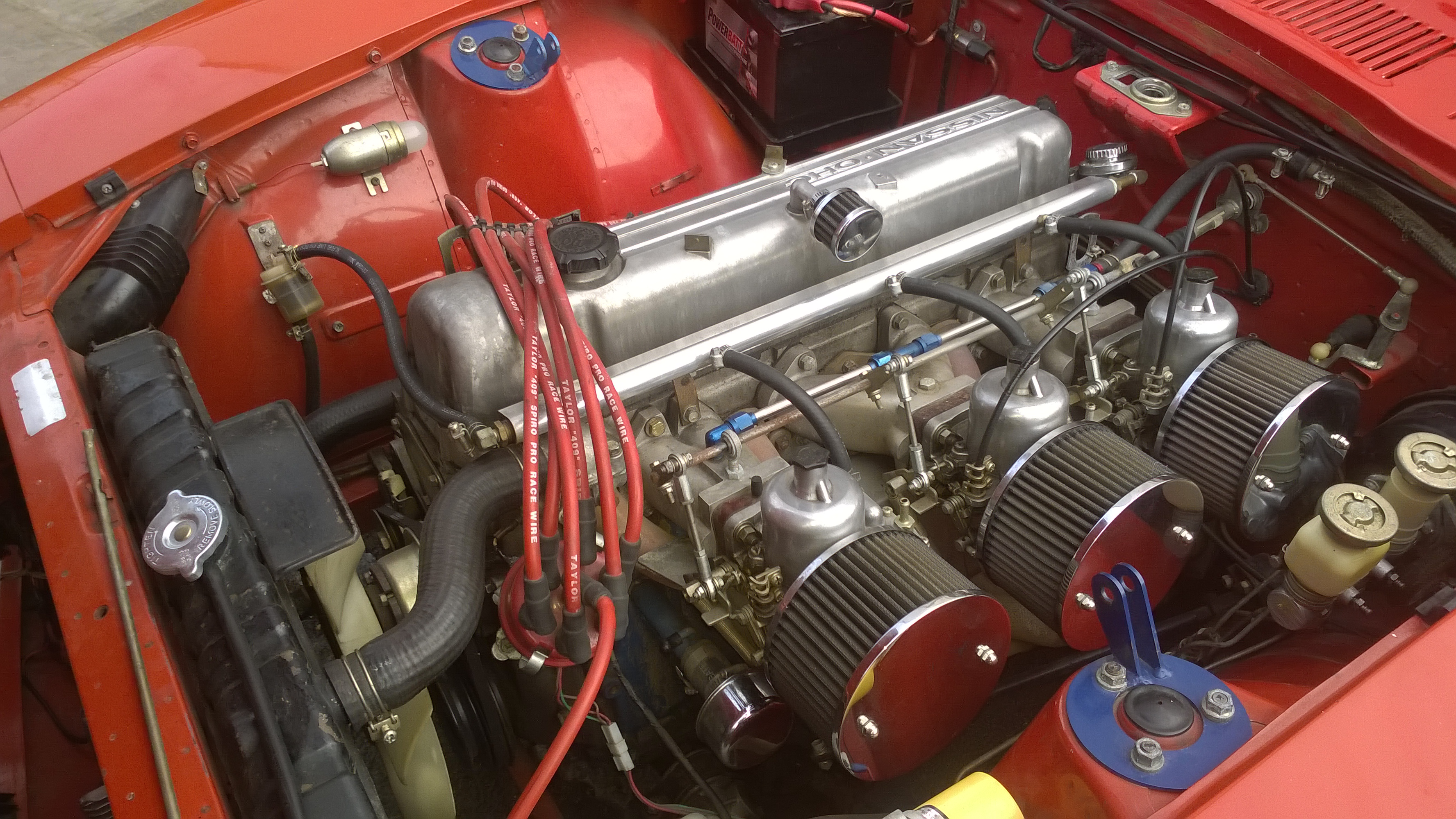

Wow, I seem to be resurrecting a 10 year old thread here, but some websearching on triple SUs led me here. So i just signed up to the forum from the UK to comment and try and research my car.
@deadflo, I know the car you referred to because i have a copy of that Z Car Magazine article. I own another triple SU car mentioned in the same article, not the yellow one in British Colombia, but a red one built by a friend of the yellow car owner. My car, the red one, later found it's way from BC to Texas in the 2000s, making me wonder if that owner was the unnamed person referred to by kmack. I know that owners id too, as the car was featured in a Z Club of Texas mag which i also have copy of.
I bought the car last year, and have made contact with the BC owner/engine builder which has helped me to in some of the cars history. But there is more to track down if its Texas years before it came to the UK for new.  only last weekend i took it to Japfest at Silverstone racetrack.

In the article, the owner creates his '263Z' by bringing together an L28 block with 240Z crankshaft and flat-top pistons.  An E31 head is retained and moderate regrind of a 280Z camshaft.  Then comes the work to convert to triple SUs .. he designed his own manifold castings from first sketches to wooden patterns for sand molds, and then manufactured them using old Detriot aluminium manifolds from a junkhard donor.  Throttle linkages, balance tubes, fuel lines etc. were custom fabricated.  Finally an exhaust header is added, 2 1/2 inch exhaust and lightened flywheel.   My car follows a similar approach by the guys friend, but retained the 280Z crankshaft.  NB.  I know that the yellow car featured in the article was eventually sold down to Oregon in 2003 after 27 years with that owner . maybe (hopefully) it is still on the road?
Love the photo!  I had the triple SU's on my car right when Steve had them built.  I thought he was going to start building manifolds to sell, but, that project may have been abandoned.  I'm heading to Salem next week and maybe I can stop by his place to see how the team is doing.  Steve isn't a big computer guy so he doesn't visit this site much, but @Bruce Palmer works with Ztherapy and might be able to provide us with an update on the triple SU project.
