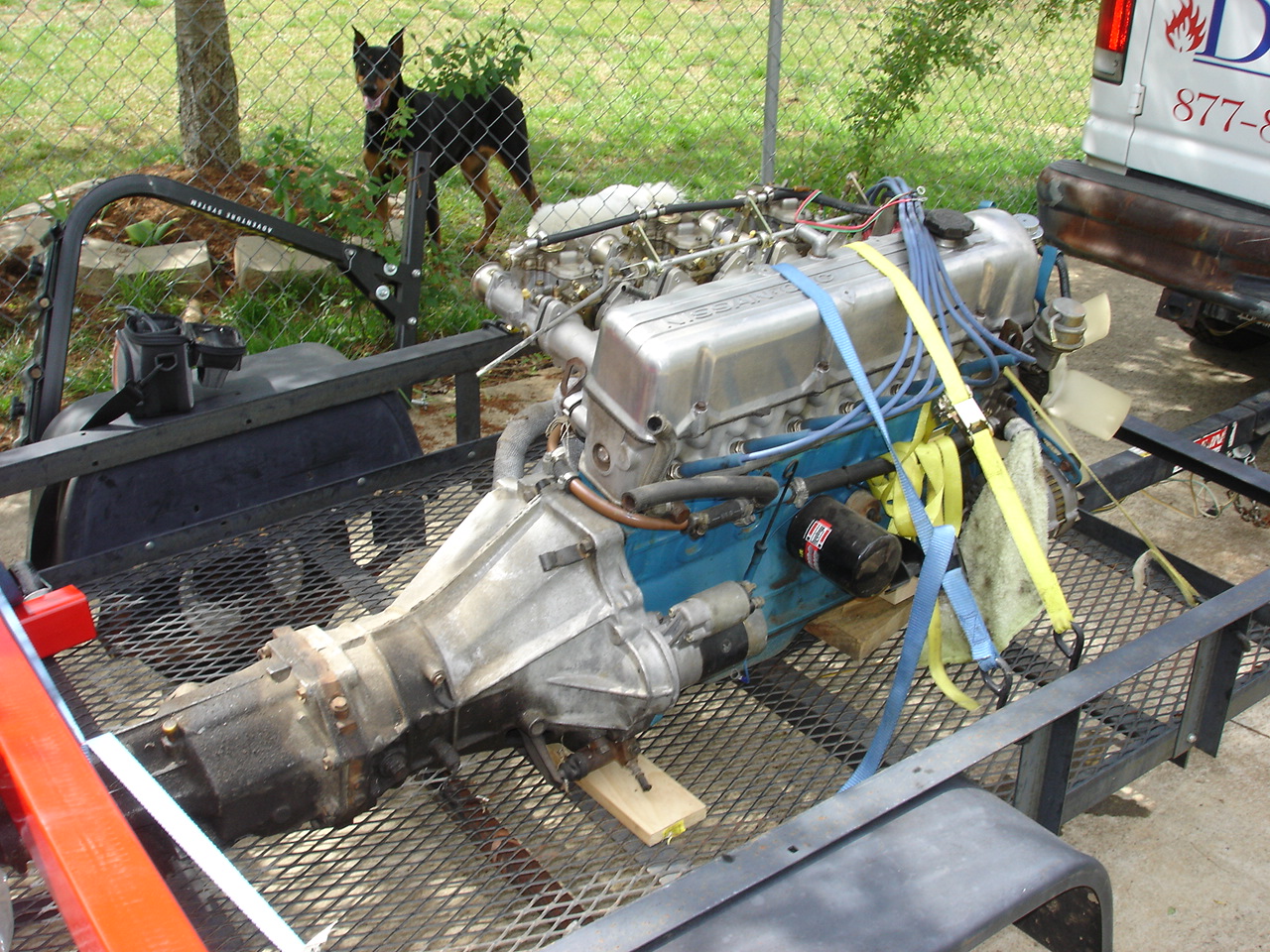

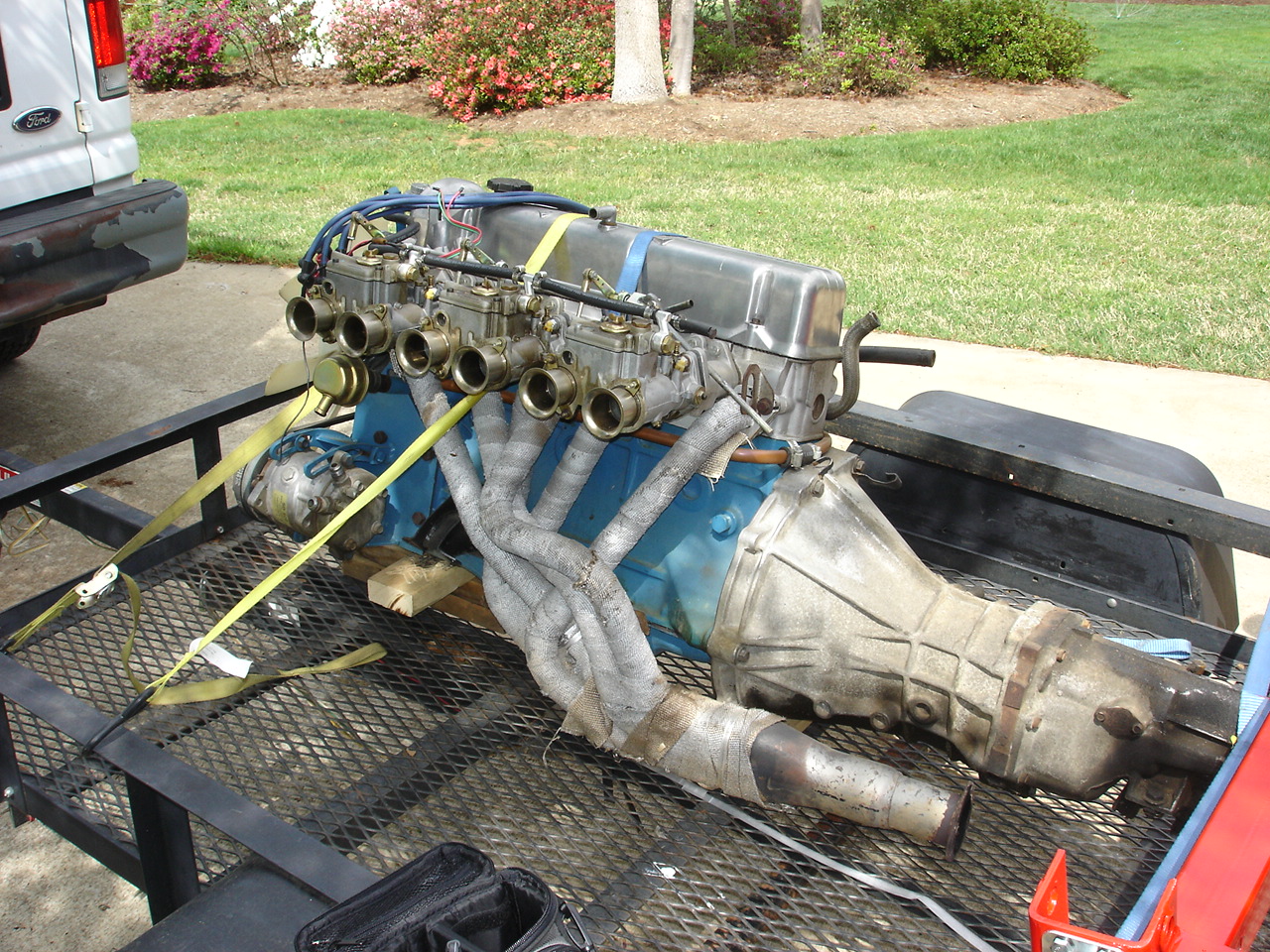

got the engine swap done ( Built 2600 with 83 zx 5 sp) question is clutch adjustment. are all the componets from the 77 supposed to work with the tranny, clutch master, slave piston shaft length. seems like I need alittle more
pedal for clutch depression. engages and disengages aprox 1 to 2 inches from the floor, lots of top pedal! clutch is a center force dual, whatever that means, and is relatively new. system has a new outa box slave and has been bled well!
Thanks in advance.
heres acouple pics of the new.
https://www.classiczcars.com/forums/topic/19713-installed-83-5sp-have/
