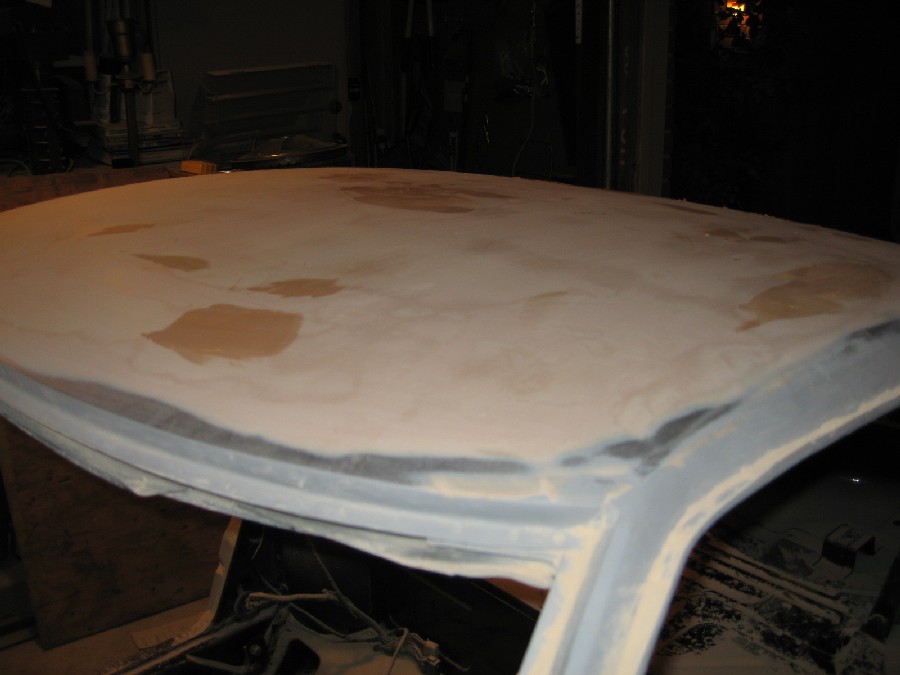

I had a REALLY bad set of waves in my roof. I had a choice of cutting off the old one and having a new one welded on, or body filler. I choose body filler and it cost me about 15 bucks in bondo (just under 2 quarts) and a lot of time, but the roof looks WAY better and was way cheaper ... will anyone ever know, probably not ... I did the prep the right way and it's covered up and sealed with 4 coats of epoxy primer. It should last a long long time.
