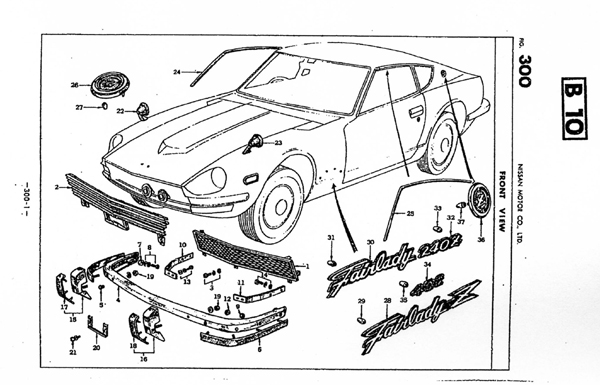

Scans from the parts catalog - S30, PS30, HS30, and HS30-H. And so that Ricklandia might understand a little better, the "Datsun 240Z" imported into North America is just one model of a whole family of Z cars manufactured by Nissan Motor Ltd. To understand the Z is to embrace the whole family.
