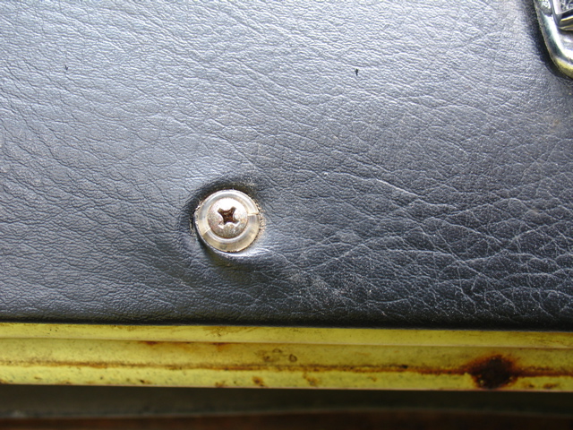

April 16, 200619 yr comment_163823 The screw would be chromed and the grommet would be either chromed of clear plastic. I would say the clear plastic grommet is correctest.My car still has a couple of these clear plastic grommets, although they are not in very good shape. Link to comment https://www.classiczcars.com/forums/topic/19494-original-interiors-of-series-1-cars/?&page=4#findComment-163823 Share on other sites More sharing options...

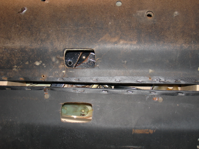

August 14, 200618 yr comment_178525 I don't recall ever seeing screws in the door panels of any 240-Z. For that matter using screws in the door panels would not be a very good idea. The spring clips used, in their plastic lags - allow the door panel to flex a bit when the door is slammed. So they act somewhat like shock absorbers... letting the door panel flex out and then spring back. So over time the door panel stays pretty much in place as it should.I suppose it is possible that if a door panel was damaged, or warped in some way - and it wouldn't comform to the door as it should - some Dealer might have installed the screws to correct some other problem. I remembered this thread while stripping my parts car this weekend. You may recall that my Series 1 car (10/70, #12746) had the screws in the door panels. Turns out my parts car (4/71, #27602) does not.Well, I have some of the panels off, and took the attached picture. The upper panel is the left panel from the Series 1 car, the lower is from the later car. Note that the Series 1 panel lacks the holes in the back-board for the metal clips. This seems to indicate that the screws WERE original to #12746. Link to comment https://www.classiczcars.com/forums/topic/19494-original-interiors-of-series-1-cars/?&page=4#findComment-178525 Share on other sites More sharing options...

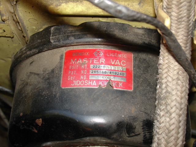

August 15, 200618 yr Author comment_178529 Arne,Thanks for the follow-up info from 12746. These screw and washer fasteners, I believe we can all agree with the research provided in these postings, were on a good number of series 1 cars. The exact number, if not inclusive to all, is purely hypothetical at this point. I was fortunate enough to acquire two of these screws and clear washers in NOS condition on ebay, but those are reserved for the quarter window interior plastic trim. Finding more for the doors may be an imposibility.Arne, does your HLS30-12746 have the original master vac decal in place?If so, I would really like to see a picture of it.DanHLS30-20419 Link to comment https://www.classiczcars.com/forums/topic/19494-original-interiors-of-series-1-cars/?&page=4#findComment-178529 Share on other sites More sharing options...

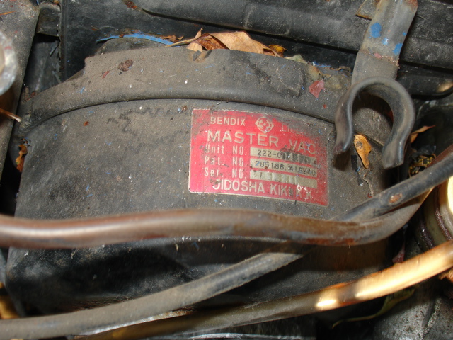

August 15, 200618 yr comment_178540 Arne, does your HLS30-12746 have the original master vac decal in place?If so, I would really like to see a picture of it. Yup. The yellow car is #12746, blue car is #27602. Link to comment https://www.classiczcars.com/forums/topic/19494-original-interiors-of-series-1-cars/?&page=4#findComment-178540 Share on other sites More sharing options...

August 15, 200618 yr Author comment_178542 Arne,Thanks for the master vac decal pics. This confirms the correct format for all cars inclusive between your 10/70 and 4/71. I am probably pressing my luck, but can you make out the numbers stamped into the spaces on these decals. I can't quite make them out. You've been a big help.Dan Link to comment https://www.classiczcars.com/forums/topic/19494-original-interiors-of-series-1-cars/?&page=4#findComment-178542 Share on other sites More sharing options...
August 15, 200618 yr comment_178550 Arne,Thanks for the master vac decal pics. This confirms the correct format for all cars inclusive between your 10/70 and 4/71. I am probably pressing my luck, but can you make out the numbers stamped into the spaces on these decals. I can't quite make them out. You've been a big help.DanThe pictures aren't clear, even at full 7.2 mega-pixel resolution. I'll try to remember to look at them in the daylight some time soon. Prod me if you don't hear back in a few days. Link to comment https://www.classiczcars.com/forums/topic/19494-original-interiors-of-series-1-cars/?&page=4#findComment-178550 Share on other sites More sharing options...
