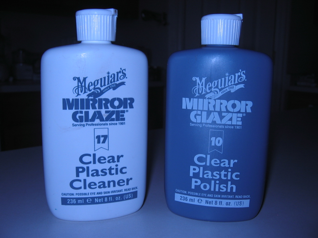

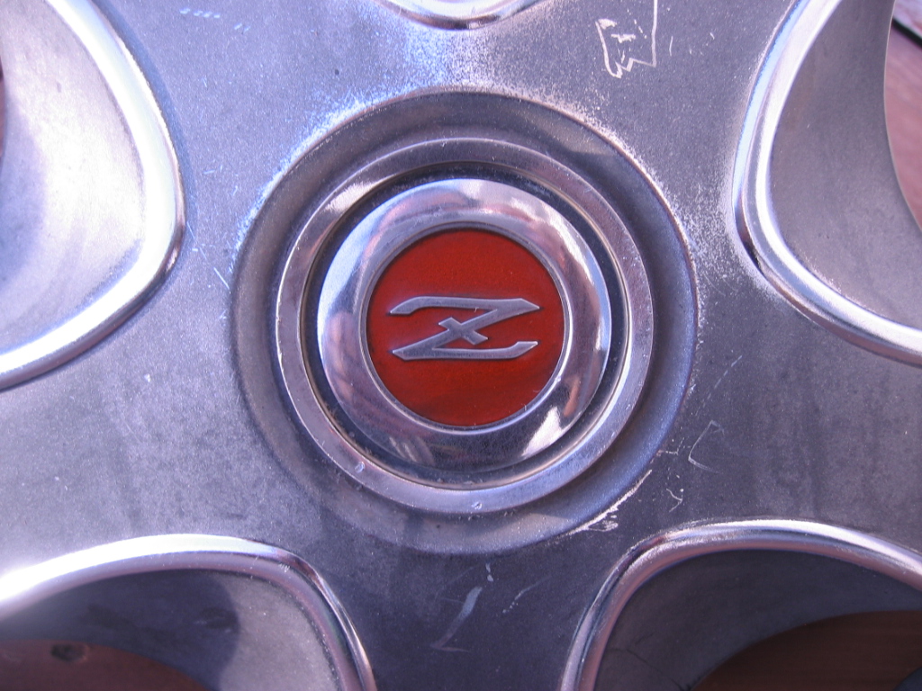

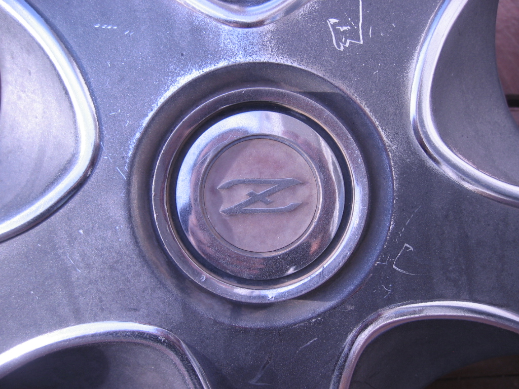

kenz240z Posted February 28, 2006 Share #1 Posted February 28, 2006 I refinished the "Z" hubcaps for my '73 a while back, but some of the center "Z" emblems were in less than perfect shape. One problem is emblems that are cloudy or hazy looking. I've used a couple of Meguiar's products on the front turn signal lenses, side markers and rear tail lamp lenses with great results (#17 Clear Plastic Cleaner & #10 Clear Plastic Polish). On a whim, I decided to try them on the "Z" hubcap emblems. Again the results were great! First step is to remove the emblem from the hubcap. I use a small pick to pry up the tabs on the retainers, then gently use pliers to remove them. Once off the hubcap, I used an old toothbrush and dish soap to thoroughly clean the emblem. Next, apply a bit of the Meguiar's #17 Clear Plastic Cleaner to a clean rag, and spend a few minutes cleaning the center of the emblem. This will take off the cloudiness & haziness. Finally, apply a bit of the Meguiar's #10 Clear Plastic Polish to a clean section of the rag and spend a few minutes polishing the emblem. This will give it a clear shine! I would imagine this process would work well to clean up the colored resin on the 260Z and 280Z fender emblems, too. Link to comment Share on other sites More sharing options...
ChrisA Posted February 28, 2006 Share #2 Posted February 28, 2006 Hi Ken, Great tips, thanks. I cant believe the "wow" factor in the red area now. Great job.Chris A. Link to comment Share on other sites More sharing options...
MarkDixon Posted February 28, 2006 Share #3 Posted February 28, 2006 WoW what a difference. I guess I need to get out in the garage and try a little clean up.My mother in-law has a Chrysler 300M that the plastic headlights are so hazey you can barely see light through them. I will try this on her car. Can't beat those kind of brownie points. Link to comment Share on other sites More sharing options...
Alfadog Posted March 1, 2006 Share #4 Posted March 1, 2006 That's incredible! Looks like you painted it. Good information! Link to comment Share on other sites More sharing options...
lonetreesteve Posted March 1, 2006 Share #5 Posted March 1, 2006 Ken,Huge difference in the before & after pics. Thanks for taking the time to take the pics & post your story. I'll have to pick up the 2 Meguiar's products you mentioned and try it out on my tailights! Link to comment Share on other sites More sharing options...
