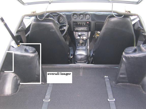

i dont know if this is a way to tell but in all the pics i see of early 74 260's the rear shock towers are shorter than the ones on the later 74 1/2 and later 260's you can kinda tell in these pics the blue on is a 74 260 and the white one is a 74 also but the shock towers are differnt heights. im guessing the shorter one ( blue one ) is a 240z body and the taller ( white one) is a 280 body. im hoping my theory is correct and i have the 240z body as mine also has smaller bumpers without all the big rubber crap. please help me out you guys have more experiance with these than i do
That difference in the shock towers is another way to say what I was saying previously. I had never seen pics of the towers side by side like that. That seems like an easier way to tell than measuring the strut OD.

I have a 73' 240Z and my rear towers look more like the taller ones in the white car. Of course my turn signals are below the bumper and I have short frame rails. Sound like some conflicting info or I read it wrong. See my sig for a link to pics.
