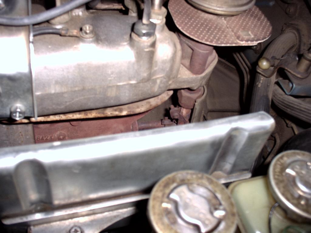

While in the process of removing the intake manifold to change my headgasket, I noticed this little pipe became disconnected. What is it, and does it look broken? I never "disconnected" it, it just came off. Is it for heating up the intake manifold or something like that?
Picture HERE
What does it look like? How is it shaped? Do you have a picture of the pipe? This stuff would help out alot.
John
Can't tell for sure, it's a bad angle. But it looks like it may be the EGR tube. It should probably connect to the bottom of the dashpot (on the end of the intake manifold) that is directly above it in the picture. At least, that's where it goes on the '83 280ZX engine in my car.

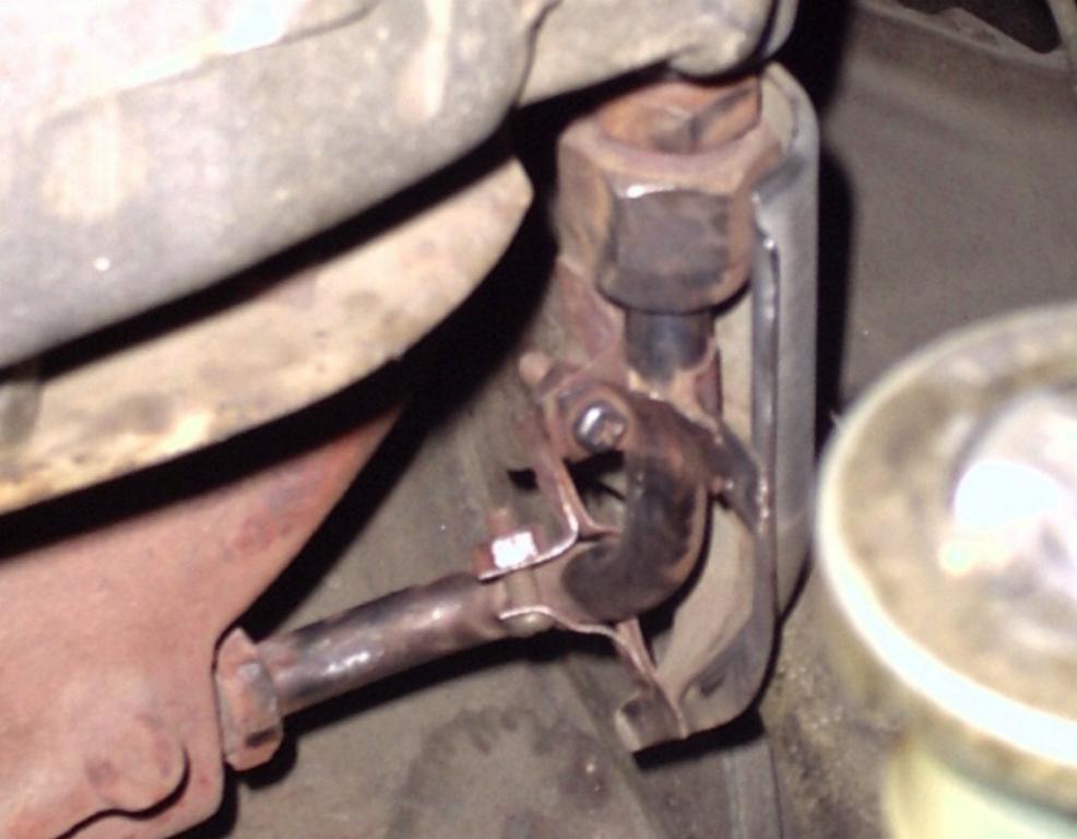

Looks like the egr pipe from the exhaust manifold to the bottom of the egr valve. It is broken. I don't know how well it can be seen in this picture because of the shield but this is how mine looks:

sblake01, that one you have pictured is the same pipe, only mine came disconnected. Is yours connected in there pretty solid? Mine just came off when I pulled the intake manifold back away from the head. I don't believe I broke anything, but It's not easy to see how it should be connected.
It bolts on pretty solid. Maybe you can see it better in this picture.
