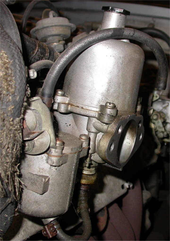

Only having the carbs off #215 to compare to, I am trying to following some of this to make sure that I probably have the original carbs (with this car, you never know!). Attached is a pic of the left carb. It is a 4-screw, so that's good, but what are "drain plugs in the front of the float bowls"? Do I not know what we're talking about because they aren't here? And that's good (for being early), right?
