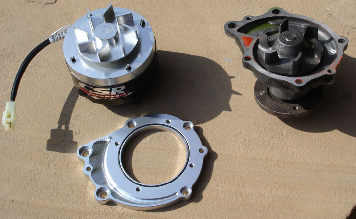

Got it in the mail yesterday.
Pretty impressed so far.
The actual pump is a modular unit that bolts into a billet adapter plate in the shape of our water pump opening in the front cover. The pump can be specified in several differenct color finishes - I chose black. It comes with requisite new bolts and a note to install a 15amp fuse inline with the pump.
5500 hour service life & knowing the Z gets driven on average 3-4hrs a day over the course of the week means that it's going to be on there for some time to come...
I'll install it this weekend and report back.

Well so far so good...
Install went off without a hitch.
Here's some pics of the pump.
I swapped out the stock 35" alternator belt and now have a 28.5" belt which does the trick just fine.
I already have a newer alternator from an 81 ZX.
So far so good as far as that's concerned.
