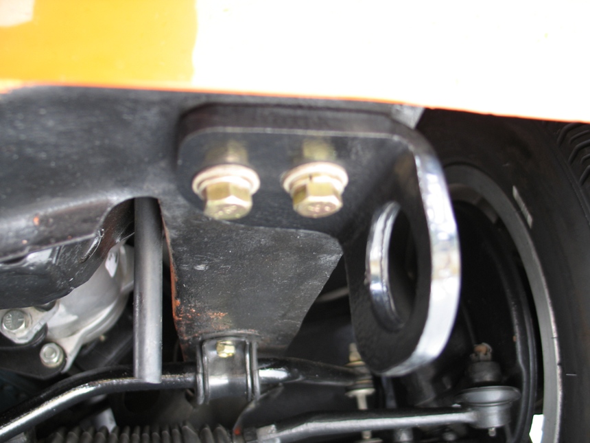

The ring on the left front frame rail is the towing ring for the car. The hooks, and it escapes me presently which one goes where, were shipping tie-downs - semigloss black with plated bolts. My chassis manual, page GI-11, Figure GI-11 says the tow ring has an "admittable load of less than 2,205 lbs. (1,000 kg)". I guess that means if it weighs more, don't admit it. It also says to avoid shock loads to it.

Here are a couple of pics of the tie downs. These are the fronts.
Bob

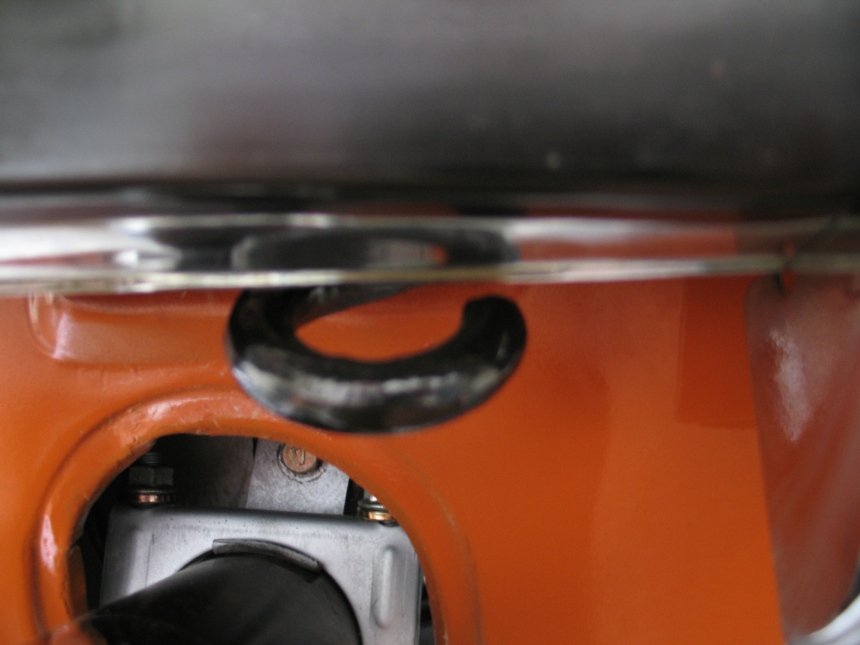

Here is a pic of the rear one.
Bob

The right front is a different shape from the two rear. The hook opening looks larger in the front, but I haven't actually measured them. They do have a different angle on them where they mount to the car. I can see if I can get a better shot but the rears are tucked up under the bumper so it is difficult to do without taking them off.
