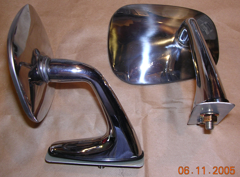

It appears to be the same, but it should be considered as "mirror parts" and not a complete "mirror", IMO.
First, there is no way to tell if the housing pivot is "tight" or "sloppy", and there is no way to tell if the "glass" adjustment is still functional. With the seller claiming it is a driverside mirror, I'm suspicious that one or both of the adjustment features are non-functional.
Be advised there is no specific "driver-side" or "passenger-side" to these mirrors. A set has two of the exact same mirror assemblies with two protective pads, two mounting brackets, and four machine screws.
Second, it does not have the plastic protective pad that goes between the mirror mounting arm and the car to protect the paint and door skin. It also does not come with the bracket that goes inside the door and is used the secure the mirror mount screws (in effect, clamping the mirror securely over a large area, not just at the screws).
The picture attached shows a complete mirror for one side of the the car. (Note: In the picture, the screws are installed backwards in the mounting bracket, the screw heads are ment to be inserted into the mirror base, through the door skin and then thread into the convex side of the bracket)

As I recall, either the front or rear screw on the Racing Mirror utilizes the original hole for the stock mirror. Then you have to drill one additional hole for the Racing Mirror. Nonetheless, the Racing Mirror covers both original holes in the drivers door. On the Right Door, you have to drill two holes for the Racing Mirror of course.

I see that from the pic. I will search for a set of these. Any ideas guys?
