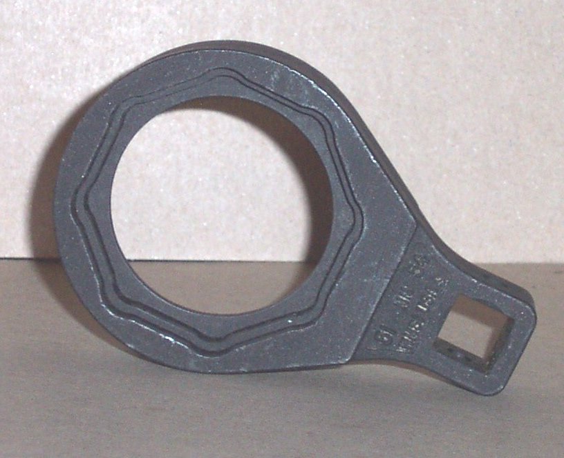

Snap-On has this tool (WMS1) which is a functional eqivalent for special tool (KV40100800) Appears to be special order only...if you want to get one from Snap-On. Not a very cheap tool tho...$75.00-$80.00. Well worth it tho, if you don't want to chew up the strut packing nut taking it off or putting it back on. Fits 51mm-54mm on one side and 55mm-58mm on the other side.
webdawg1
webdawg1
what is the tool you pictured?
I don't see how that's the one I would need for the "nut" at the top of the strut casing. The nut that's at the top of my front strut casing on my 73 is round with two 3/8" square tabs cut out 180degrees from each other...

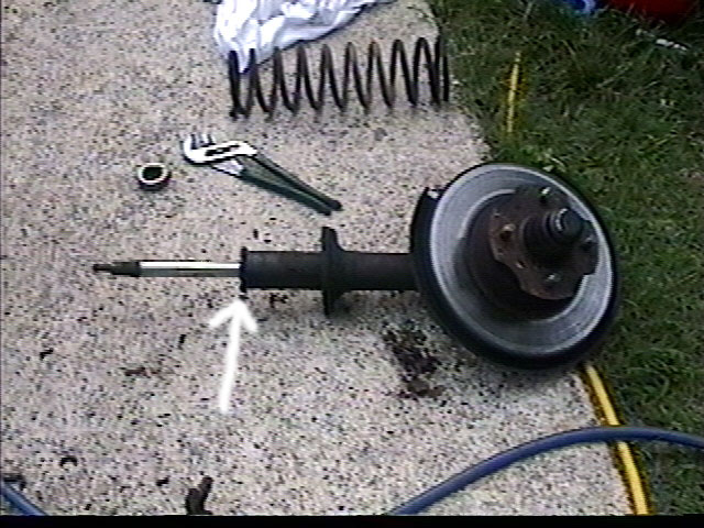

I looked in google images for some pics of 240Z struts and here's what i found...

Eric, I use a pipe wrench as well. It does "Bite" into the gland nut (or "Grand Nut" in Japanglish) a bit. Just a note: I've seen gland nuts like you desribed, with two flats and nuts with the full hex. One time, both on one car!

Word of caution when using a pipe wrench on the strut gland nut! Be carefull not to slip off the gland nut and ding the insert shaft......good way the F-up your day and the insert. :stupid:
