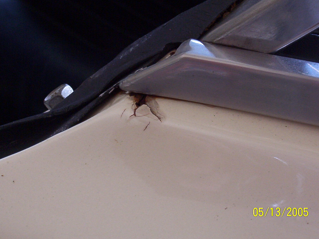

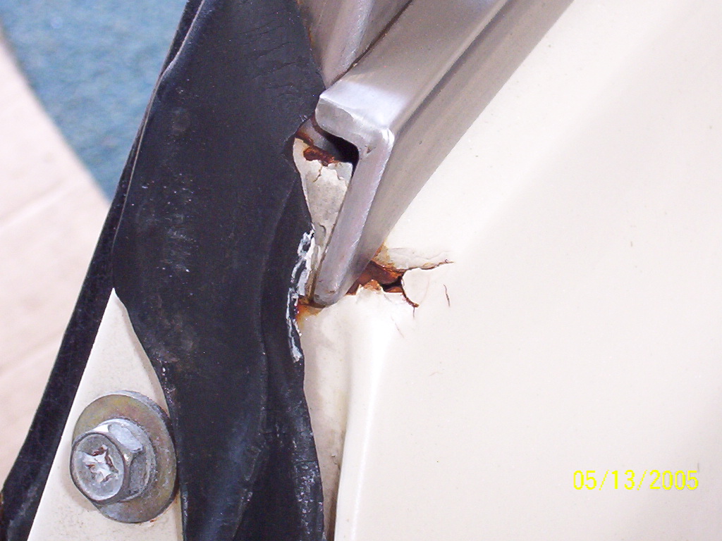

My 71 has begun to get cracks in the metal at the top, forward part of the doors, right where the window frame and the horizontal molding meet. Anybody else ever have this occur? What would be the best fix, short of replacing the entire door?
https://www.classiczcars.com/forums/topic/15916-cracked-doors/
I've got that on my drivers door. Doesn't seem too uncomon judging from this post. If it is a stress crack, then mig, tig or arc welding probably wouldn't be the best bet because the weld is harder than the surrounding metal. This would help it to re-crack. Oxy might be the better option as the weld is a little softer.
Any experts out there as I'm just guessing?

Most of the time, this damage to the door skin is caused by improper adjustment of the window frame. This is especially true after installing new door weatherstripping. Some complain that they have a hard time closing their doors, or have to slam the door to close it. To cure this, loosen all the window frame bolts, adjust the door to fil properly, then adjust the window frame to fit properly. If the top of the window frame is adjusted too close to the weatherstripping, it will act as a lever and apply great force on the outer door skin where it meets the inner portion of the door, resulting in the outer skin pulling away or spliting. This can effect either the top front or rear of passenger or driver door.
