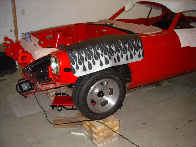

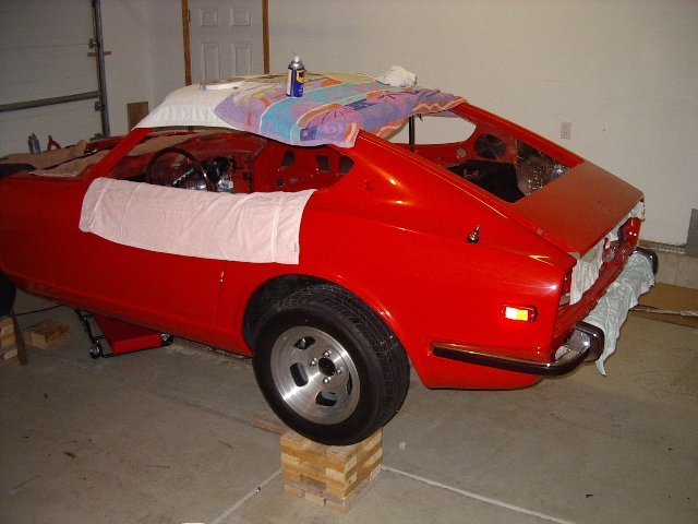

I agree, start with the fuel/brake lines. Then the E-brake, suspension, then take it off the rotisserie. I put my rear bumper on before the gas tank to have easy access to the side bolts. Once you get your Z back on the ground you can finish the brakes and the driveline components. I have my Z on stands to make it easier to work on. I'm now working on the interior and the door window and lock mechanisms.
