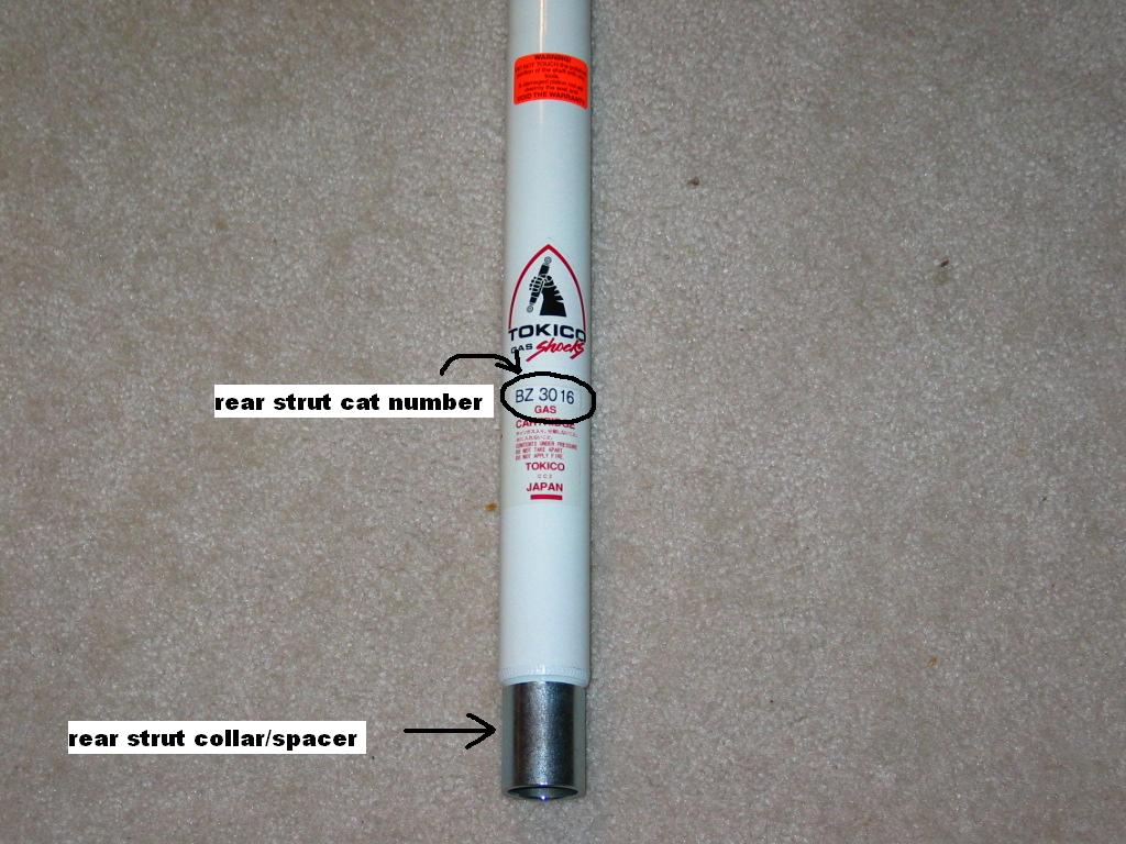

Someone was asking about collars welded to the front struts? I don't see any on my set. EDIT: Yes the collars are there, i was looking at the rear (which i thought were the fronts). They don't seem to be welded on, they are stuck over a lip in the bottom of the strut (like a sleeve).
Xray, maybe you removed these?
The collars go on the rear strut cartridges. It's pretty tough to get them mixed up. HZ 3016 and BZ 3106 are the rear spring/strut cat numbers. xx3015 is for the front.

Xray, i'm 90% positive the collars go on the front. Since you haven't put the back in you may have gotten them mixed up. Or maybe i'm wrong? Can any one else verify this?
Tokico cat number BZ 3016 is the rear strut cartridge. A metal sleeve is on the bottom of the strut to approximate the necessary length dimension. Picture included.
check link to confirm cat number.
illumina cat number 240Z
Tokico BLUE struts have the same collar. It's on the REAR struts. (similar part number too, ending in 3016) It was reported here in Sept 0f 2003 and appears to be the result of Tokico phasing out some strut models and modifying other struts to take their place.
