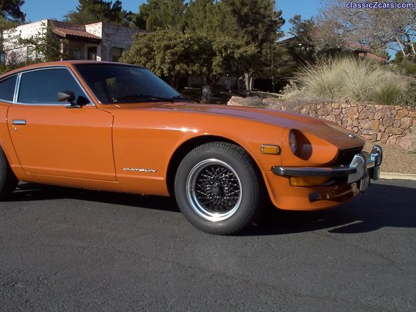

As you can see, the top four turns are loaded when car is on the ground, and the bottom 5-6 turns remain open. I have not experienced the car bottoming out. Looks a little different, but I signed my warranty card, and if Tokico says this is what works with the Illuminas, then they are putting their money where their collective mouth is....
Overall, I am satisfied. They have been on the car 2 months (maybe 40 miles driven to and from mechanics and body shop), and it handles much better than I had expected.

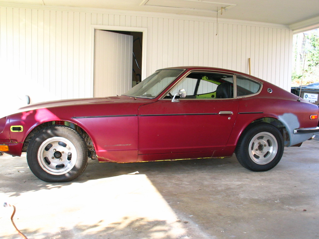

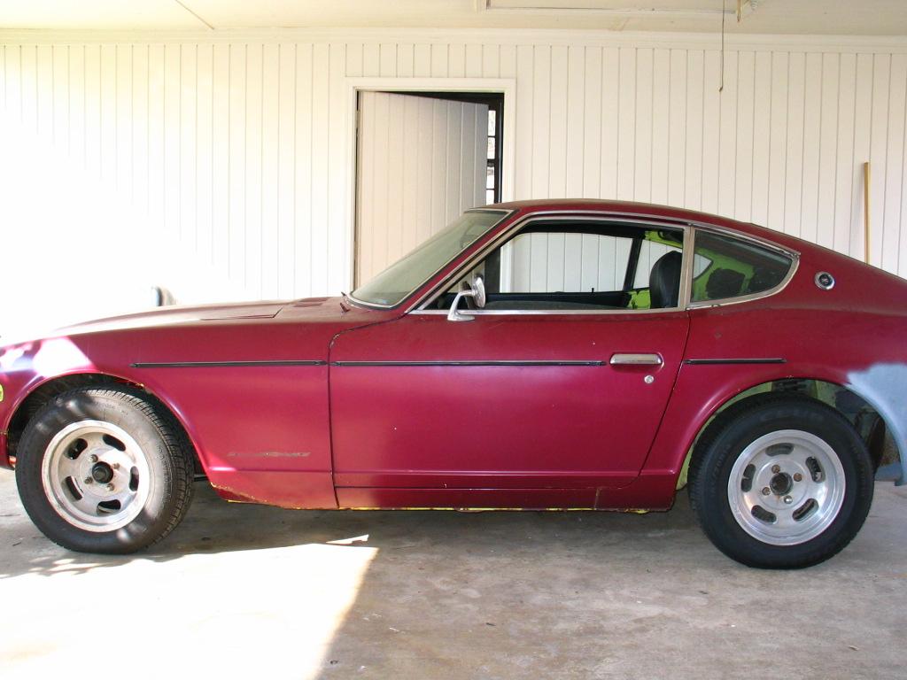

Here's my car from the side, 2 views. Keep in mind the following:
1) Car already sags a bit because the 33-year old springs have probably sprung their last, well...you know
2) Car has 185/70 tires on it which lowers it some (not my intention to keep those tires, but they have 80% tread left on them). Having low tire pressure in front doesn't help much--ugh!
3) Rocker to ground clearance is just a shade over five inches.
4) Front has the Tokico setup, the rear is still stock (not a whole lot of time these days...)
Hope this helps,
X

From the pictures, keeping all your caveats in mind, the front still looks a bit high to me. In fact it looks about as high as mine and I have Euro Springs. I was hoping that the Tokico's would bring the car down a bit. Perhaps yours needs to settle, I don’t know. However, my desire is to get mine about an inch and a half lower than what I have now. The picture here should give you an idea……
George
Umm, I hope my springs don't "settle." Wouldn't that mean they can't hold their form under load, and basically lose their "springiness?"
The whole point of buying these (for me, at least) was NOT to have a significant lowering effect on the car. If you want that, look to Eibach or KYB or other brands. Tokico springs may lower a 240 about 3/4", at least according to the MSA website, and I have found that to be true.
