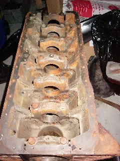

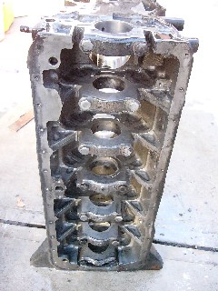

Here is what my L24 block looked like before I attempted electrolytic rust removal on it. It had been degreased, but the rust remained. The guys at the machine shop said "it's not as bad as it looks" when I picked it up. It sure looks bad to me.

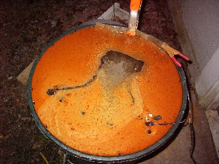

After 24 hours in the solution, this is what the garbage can looked like. When you know that the rust-colored stuff is rust rising off of your parts, this is a beautiful sight.

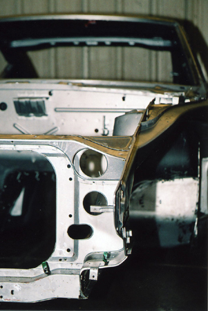

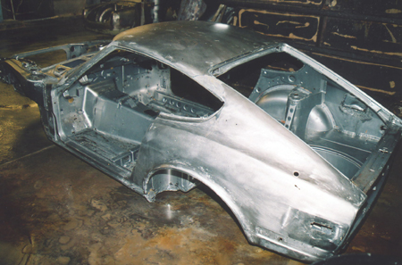

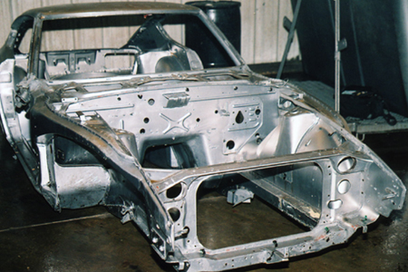

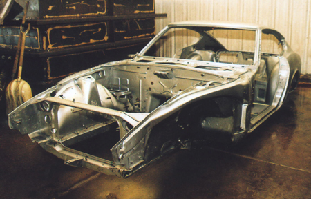

This is Her Majesty the 26th, bare naked metal and 100% rust free. She also has some holes where rust used to be. Poor thing. She is just out of the tank and has not been wiped down yet. These pictures are from this morning.
She sat in the electrolysis tank for three days after all the paint and junk was stripped off. The plastic covering on the wire harness metal tabs has not been harmed nor has any of the lead filler. She is 100% rust free inside and out. Cool, huh?
