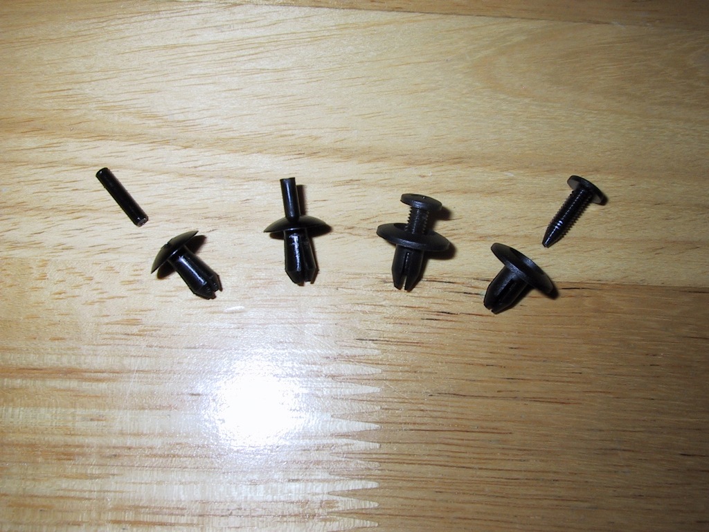

March 7, 200520 yr comment_115549 As I mentioned in a previous post my local auto paint shop carries a selection of fasteners as might be required by auto body shops. I went ahead and ordered a box of rivets that were listed as applying to Nissan and appeared to be a close match to what we require. I'm not sure which models these were used in but I'm guessing that Nissan learned a lesson and came up with a better alternative. As you can see in the attached picture these use a plastic screw with a phillipps head instead of the smooth push pin. While the head is slightly larger that's not really a problem. The barrel part is slightly too big which makes for a tight fit. A box of 25 of these was under $10. MSA lists the original rivets at 10 for $6.50 and people seem to often pay far more than that on eBay. Link to comment https://www.classiczcars.com/forums/topic/14649-interior-rivet-alternatives/?&page=3#findComment-115549 Share on other sites More sharing options...

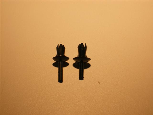

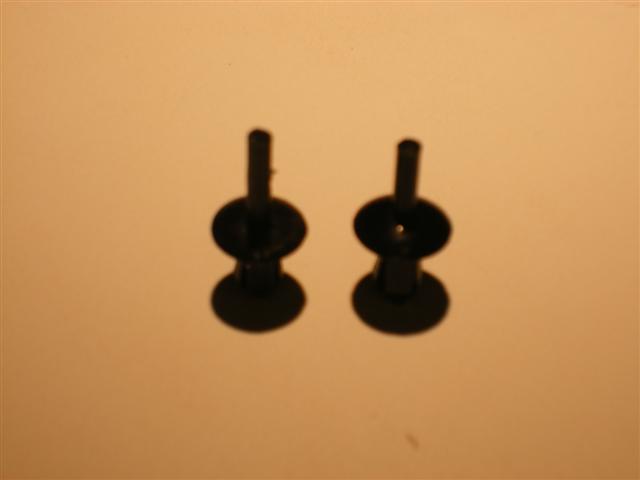

June 30, 200618 yr comment_172809 For those interested, I've located a decent replacement for the black interior retainers (rivets). These are nearly identical to OEM with the following differences. The finish is satin instead of shiny and the head is about 1-2mm smaller in diameter. Unless you're stuck on originality or doing a concours restoration these should make you very happy. I can provide them at .35 cents apiece. Aftermarket is on the left and original on the right.The photos are the best I could do with my camera. Link to comment https://www.classiczcars.com/forums/topic/14649-interior-rivet-alternatives/?&page=3#findComment-172809 Share on other sites More sharing options...
