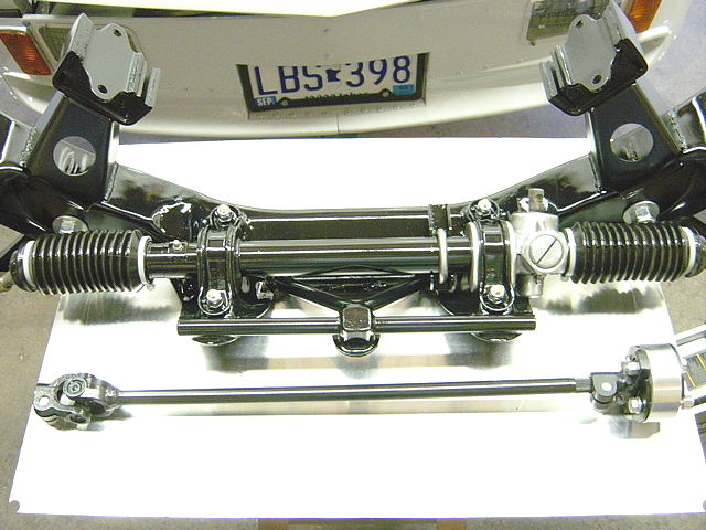

Michael,
I thought I would polish the aluminum to add a bright bit to the lower part of the engine compartment. I also thought about chome plating the steeering rod, and the brackets for the steering insulator.
SNIPWill
Hey, don't redneck your Z. Buffing aluminum...Chrome plating, sheesh. :sick:
Actually if I could do it all again I would probably just have it all powder coated. I had a tough time with the POR-15 - especially the top coat. I didn't follow the rules exactly right so I think it'll all peel off at some point. The POR-15 is adhered properly but possibly not the chassis black. POR is such a pain in the arse to work with. It's good for large areas but with lots of little parts it gets very difficult to time the coats just right for proper adhesion or do all of the sanding you have to do. They need to make it easier to use ie paint right over dried coats with no prep needed. Even though it looks nice in the pics I'm not really happy with my suspension when I take a closer look. Wasted a lot of time with it frankly. I guess you have to learn somehow!

Michael,
Treating the aluminum with metal ready (which I did not do) is supposed to make the POR15 stick!

Hey Bryan,
I am not talking about carbon fiber coating, 6" tailpipes, bikini clad mud flaps, carpetting dash, hanging fuzzy dice, attatching rebel flags, gun racks, or laying a chewing tobacco stain flowing down diagonally from the driver side window.
I am just applying the judges rules for driver class-consistancy throughout the car.
Changing the Yellow cadmium to chrome for two 1/8"wide bands on the steering rack, and buffing the area circled in blue on the picture below-part of it will be covered by the rack bushing as well. I do appologize if that is what a redneck in your part of the country would do, but, if you want it different, buy my car and do it your way, otherwise, I have only one person to make happy with my car, ME! That said, I do appreciate your opinion, I just don't happen to agree with it in this instance!

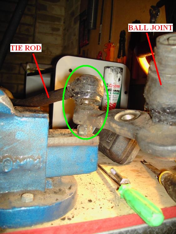

Guys,
I am not sure what this steering joint is called but how on earth do you seperate the "steering arm" from the tie rod. I have circled the joint I wish to disassemble. Are these joints readily available and what is there proper name?
I removed the castle nut but the "steering arm" seems fairly seized and with the joint able to freely move, there is no way I can see to get decent leverage. Haynes manual refers to using a ball joint removal tool but I am not sure what they are.
Any pointers would be great.
James
You have it right, The tierods are readily available-any national chain, most local mom and pops, MSA, VB, ebay.... I used a pickle fork to get mine apart(cheep tool), but there are specialty tools available as well.
Will
Drunkenmaster, the shaft (threaded extension of tie rod end) is tapered. The hole in steering arm is also tapered.
In your photo, remove nut and strike down on steering arm. This will seperate the two parts. I assume you will use new tie rods (if not then leave nut on, but give some room from nut to arm. You won't bugger threads to bad then).
