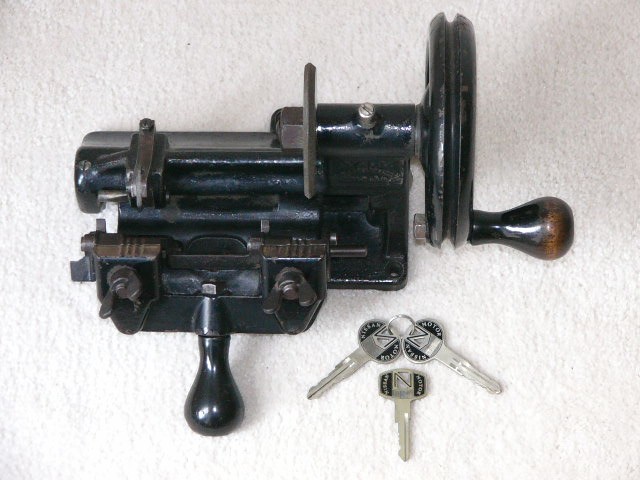

March 31, 200817 yr comment_242565 This subject was dealt with in earlier threads ! I'm a locksmith , and after 25 years of dealing with automotive locks, it never ceases to amaze me to what extent people will try and go through to chase down lost keys on the cheap. A competent locksmith will have good code programs in his arsenal , and at the least an old book of codes . From there he / she can originate keys by using either a punch machine or a computer controlled mini cc machine , google ITL1000C for example . You will end up with factory perfect keys ! Now for the people who have lost their keys and codes, hire a MOBILE locksmith , and have keys made on the spot . Don't waste everybody's time and just bring one lock to a shop , you cheapskates out there ( unless you really are broke , then go ahead :nervous:) . This rarely works . So there you go . A competent locksmith , a few bucks , problem solved ! Yes there are variances to early Datsun systems , but late '70 and later are all double sided keys . You can get ALL locks to work on ONE key if desired , once again call a good locksmith . ( I've got GM locks on the doors of my '70 ! They retrofit quite nicely, and no one can pick 'em or ''wiggle'' their Datsun keys in my locks and open the doors ) . Lots of options available , just phone a locksmith, not Mcguiver shadetree to ''save'' money . Link to comment https://www.classiczcars.com/forums/topic/12756-key-codes/?&page=4#findComment-242565 Share on other sites More sharing options...
