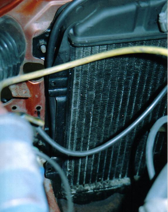

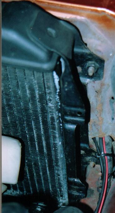

Attach pics of your chassis underside.
And your radiator support.

G'Day there mates, I was worried for a while there; I couldn't find you all. Eventually checked in with Alfadog who put me in the picture. Now I'm having fun sorting out this new setup.
Anyway, when I finally got around to developing the pics of the radiator in "Precious" I couldn't find the site. So, here they are, LH side and RH side.
(Hope this works).
Rick.
