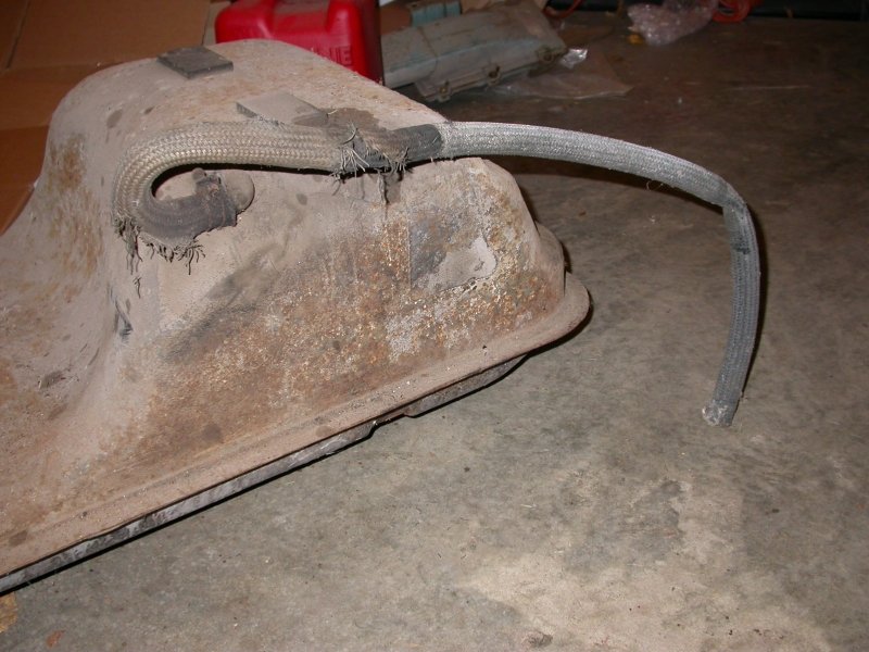

The only hose you should have a problem with, is the one at the rear (passenger side) which has a 180 degree bend in it. Using generic fuel oil rated hose in this location will not work unless you can find a way to keep it from kinking at that bend. A kink there will render the vent useless. Some folks have used a steel spring inserted in the hose to keep it open. I just bought that one hose from Nissan ( about $50) and used generic hose for the others.

If you can find a 180 degree steel tube and a short length of hose to make the turn, then you could use generic hose. I couldn't find one at my local hardware store, so I took the path of least resistance (OEM hose).

I removed the evap tank and eliminated all but the small vent line that runs to the front of the car and the one that has the 90 deg bend that is 5/8" in dia. there is enough room to allow for a gradual 90 and it wont kink if given the right amount of slack. B-killer is right there is a vent line from Nissan that fits this and is pre bent. In fact there is a line for this vary vent that allows to remove the evap tank . This tank was only required in the US . I have the part number if you need it some where , I think they are about $30. from midwestz Chloe knows the number and can get the part. Gary

Right. At least two of the cars on the board (26th-Z and mine) have established that ours came without evap tanks because they were made in 1969, and the laws didn't mandate the evap tanks until 1970. Got a new hose from Chloe, but we did it by picture and not by part number. Pic of the one originally on my car attached.
