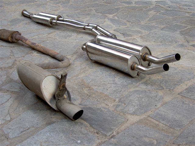

Hi Guys,
I likes the idea of Twice pipes but living the wrong side of the water to buy them I decided to make my own system. I used a couple of RC40 exhaust systems that are noramlly fitted to a Mini. After some 6 hours of cutting, modifying, welding & swearing it was finished.
The results are good, it is not noisy at all at motorway speeds but on acceleration it sounds great & most important the system should be good for no power drop up to 260 bhp ! The car´s performance has certainly improved on the first shakedown run along the motorway the car was pulling an indicated 218 kph before I thought about my driving licence. The car certainly pulls a lot harder from 4,000 revs to 6,000 revs. I need to take the car to the local rolling road to reset up the car & confirm the results. I´m busy for the next couple of weeks but asap will report back.
