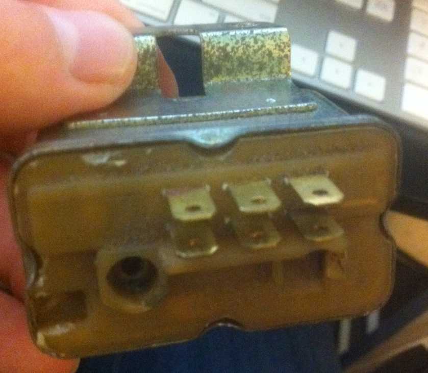

Yes, I've seen that one, too. Since I didn't have a 280Z to tear into, I didn't mention it, though. I was trying to help someone on facebook with replacing the ignition relay. Some day I'll have to post how to use a DPDT relay to use as a substitute.

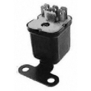

On the other hand, I think SMP has a replacement ignition relay...I'll see if I can find the part number.
Edited by SteveJ
This relay, RY-199, from Standard Motor Products looks like it might work for the ignition relay. I've added an image of a Z ignition relay for reference.

Thanks for the info on relay options. Could come in handy in the future, but thankfully there's nothing wrong with my relay at this time. The car works fine... The diagram doesn't. :)
