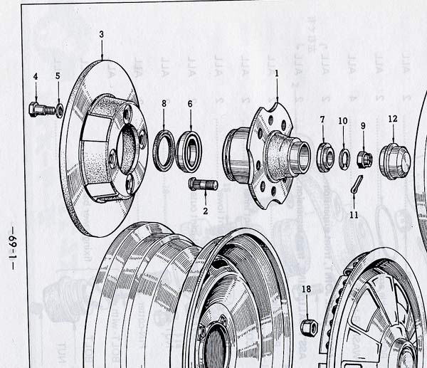

Hi David,
That's "Factory".
The early type rotor did indeed have a vented 'hat'. They were superseded pretty early into production, but I don't have any information on exactly or even roughly when it may have been.
My current project car, a Fairlady Z-L built towards the end of 1970, still had them on it when I started to rebuild it. However, they were warped, rusty and had already been re-faced at least once. They were junk, but I have no doubt that they were the originals that came with the car when it was new. This car had several parsimonious owners before me!........
The part number for the early ( vented hat ) rotor was 40206-E4100 and this was superseded by the non-vented ( I believe ) type 40206-E4101.
The sheetmetal dust-shield is also different on the earlier cars, as it has what amounts to a scoop shape pressed into it. Later cars did not have this.
Here's a pic from the early Japanese parts list, which shows the 'vented' rotor quite clearly:
Alan T.
