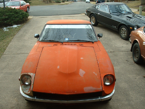

February 22, 200421 yr comment_69489 Thanks! It's really confusing. I just got this in my e-mail, how pertinent, number 793 with a 12/69 build date. There is just no real answer to what happened when. I know of a fellow who claims he used to own #1776 with a 12/69 build date. There have been many discussions about what parts appeared on what cars. "kats" has contributed a wealth of info and you should check out his site http://www.geocities.jp/datsunz903/"HLS30-H" has posted numerous pictures from parts books I lust after showing parts and numbers with far better descriptions than I have. The more I look at parts, the more differences I find.What particular part (parts) are you having trouble with, billramsey2002? Link to comment https://www.classiczcars.com/forums/topic/10294-early-or-late-240/?&page=2#findComment-69489 Share on other sites More sharing options...
February 22, 200421 yr comment_69490 Whooops! What happened to the picture? Link to comment https://www.classiczcars.com/forums/topic/10294-early-or-late-240/?&page=2#findComment-69490 Share on other sites More sharing options...
