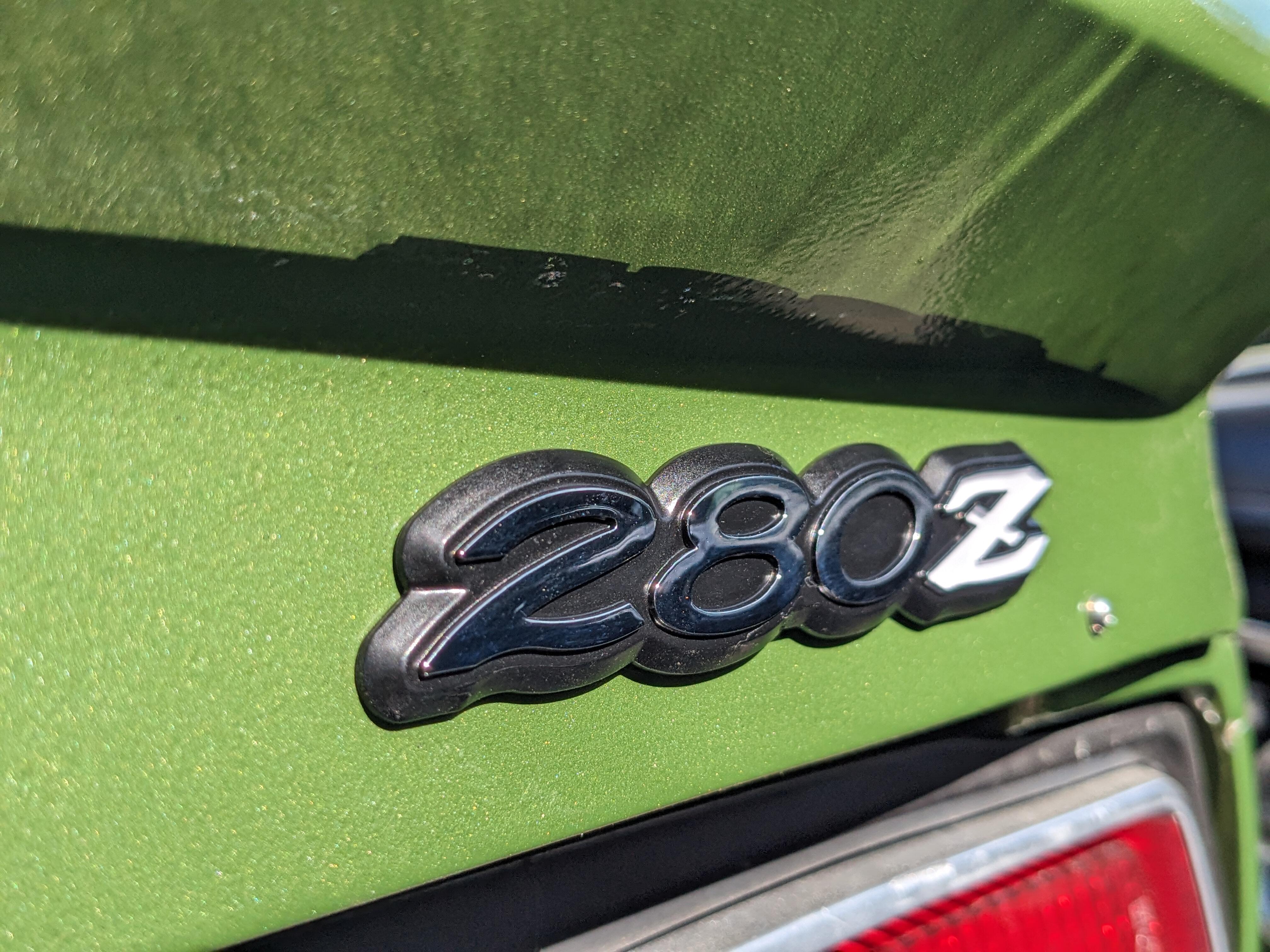

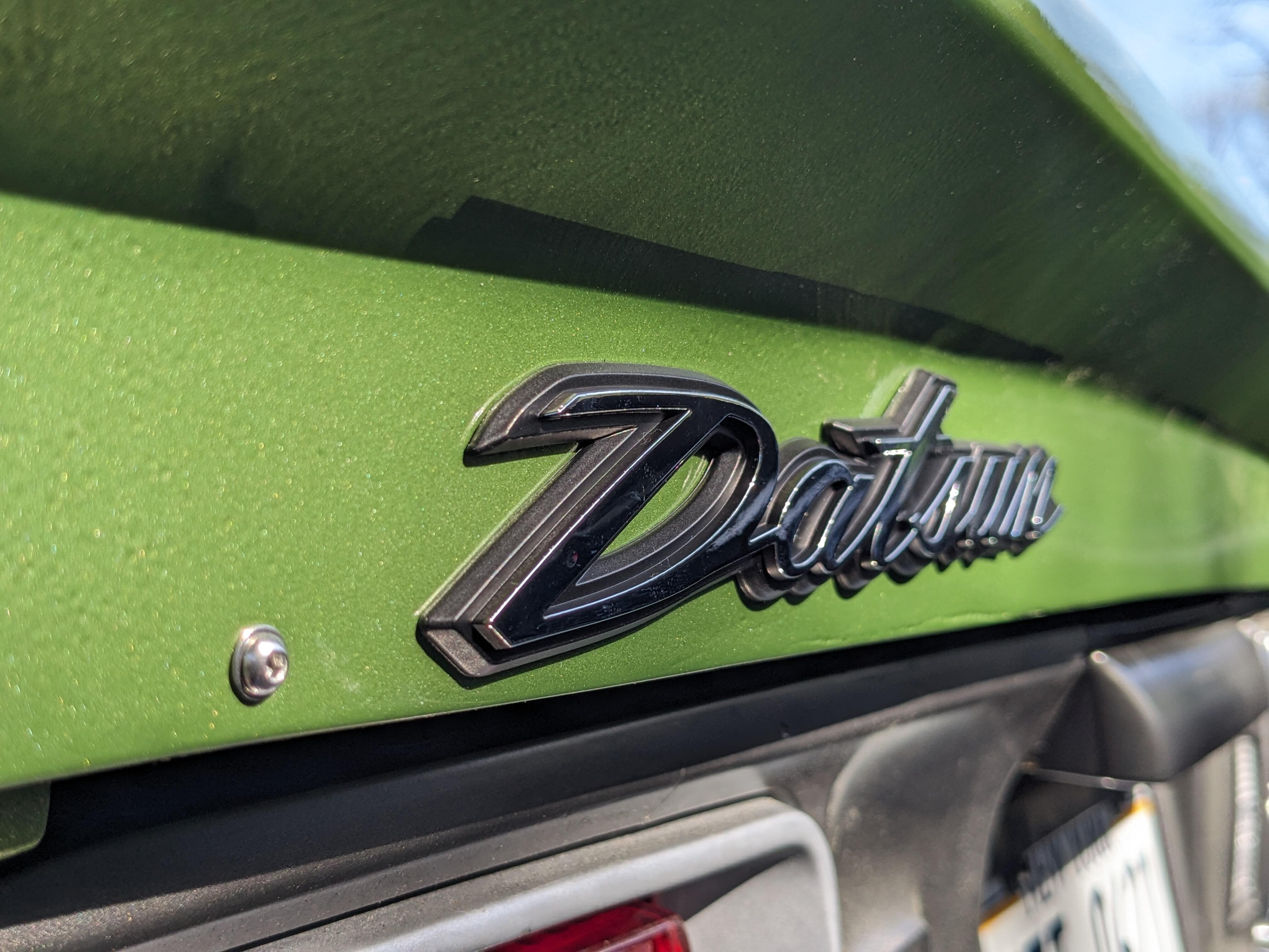

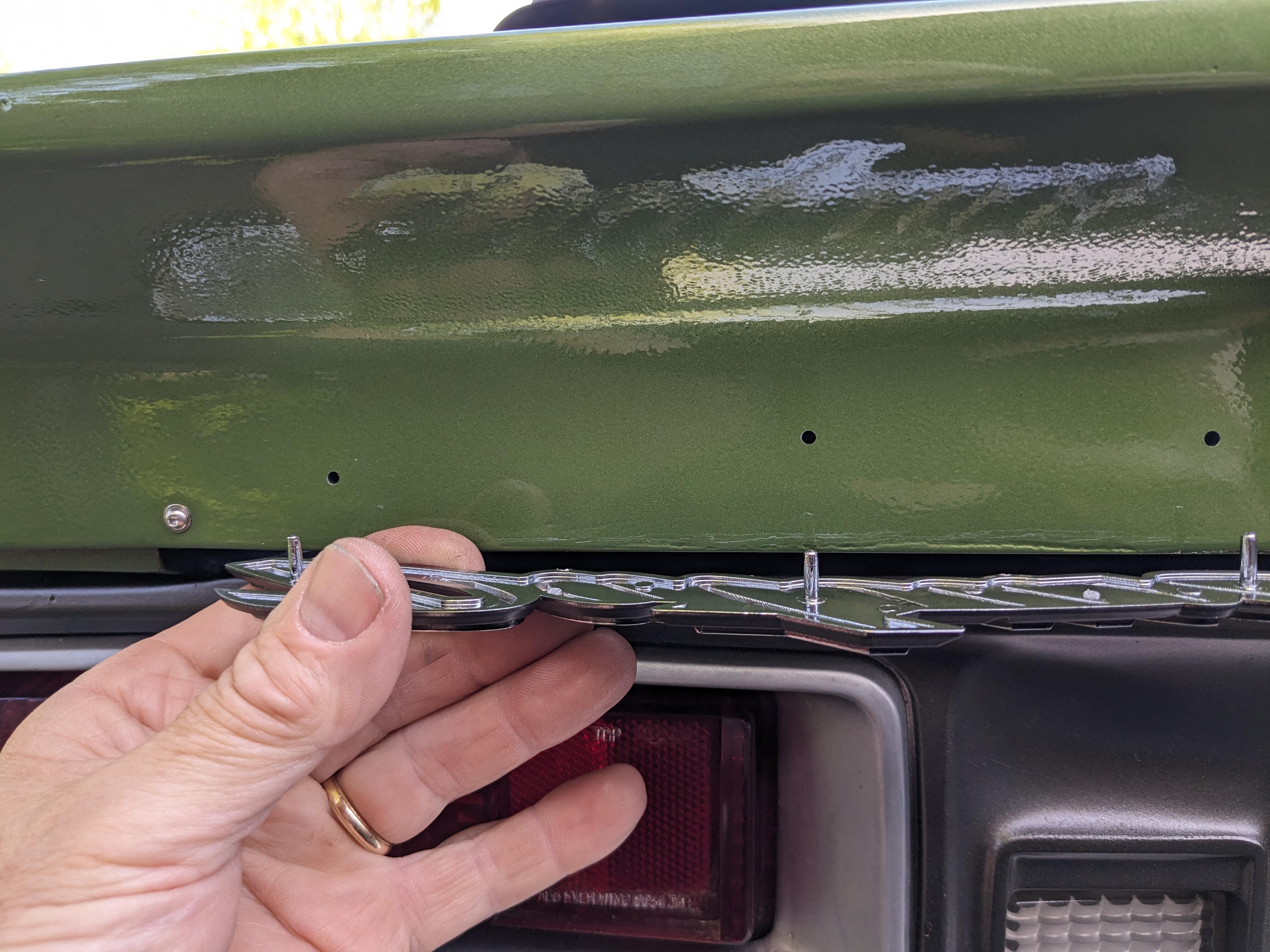

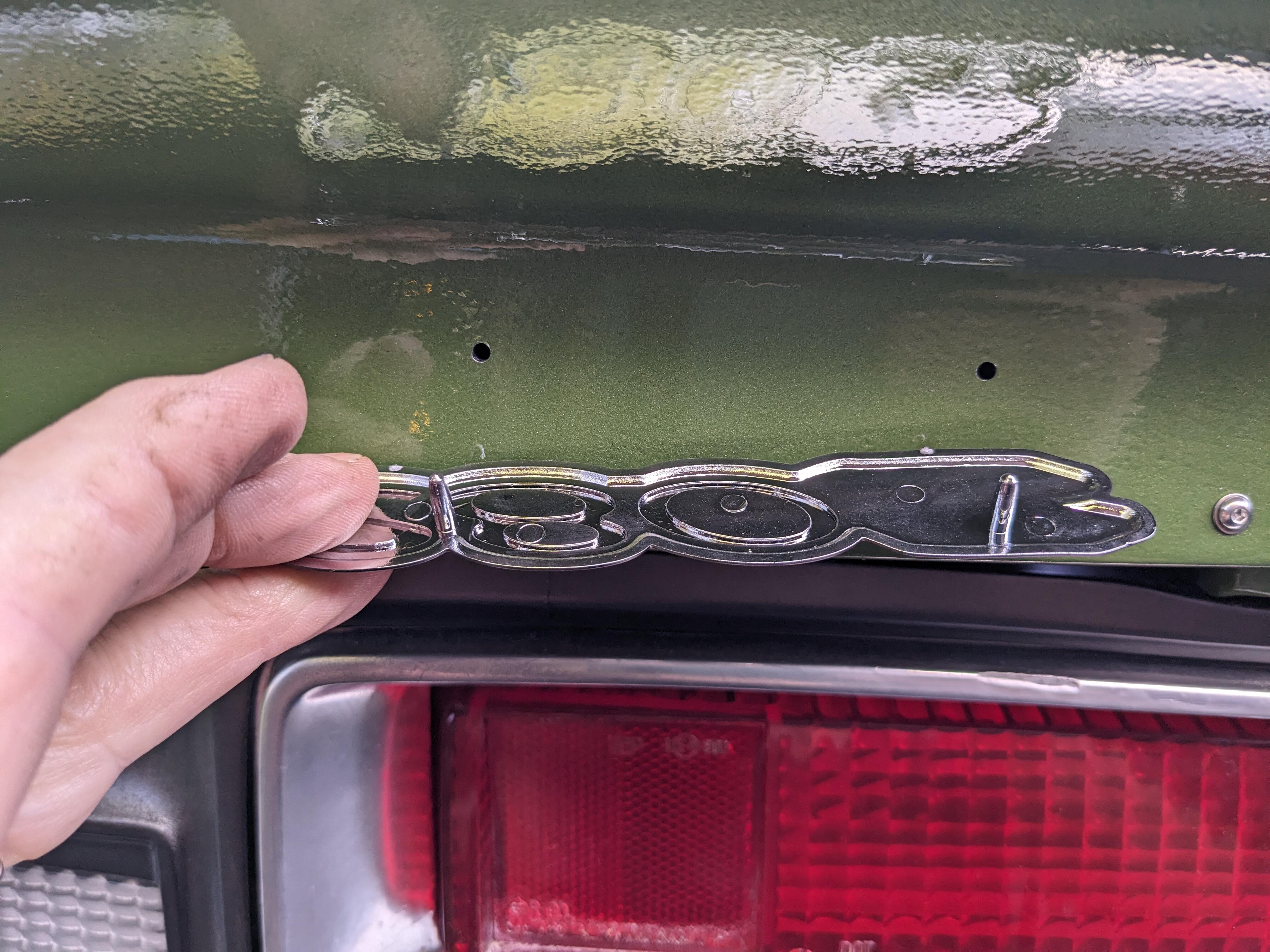

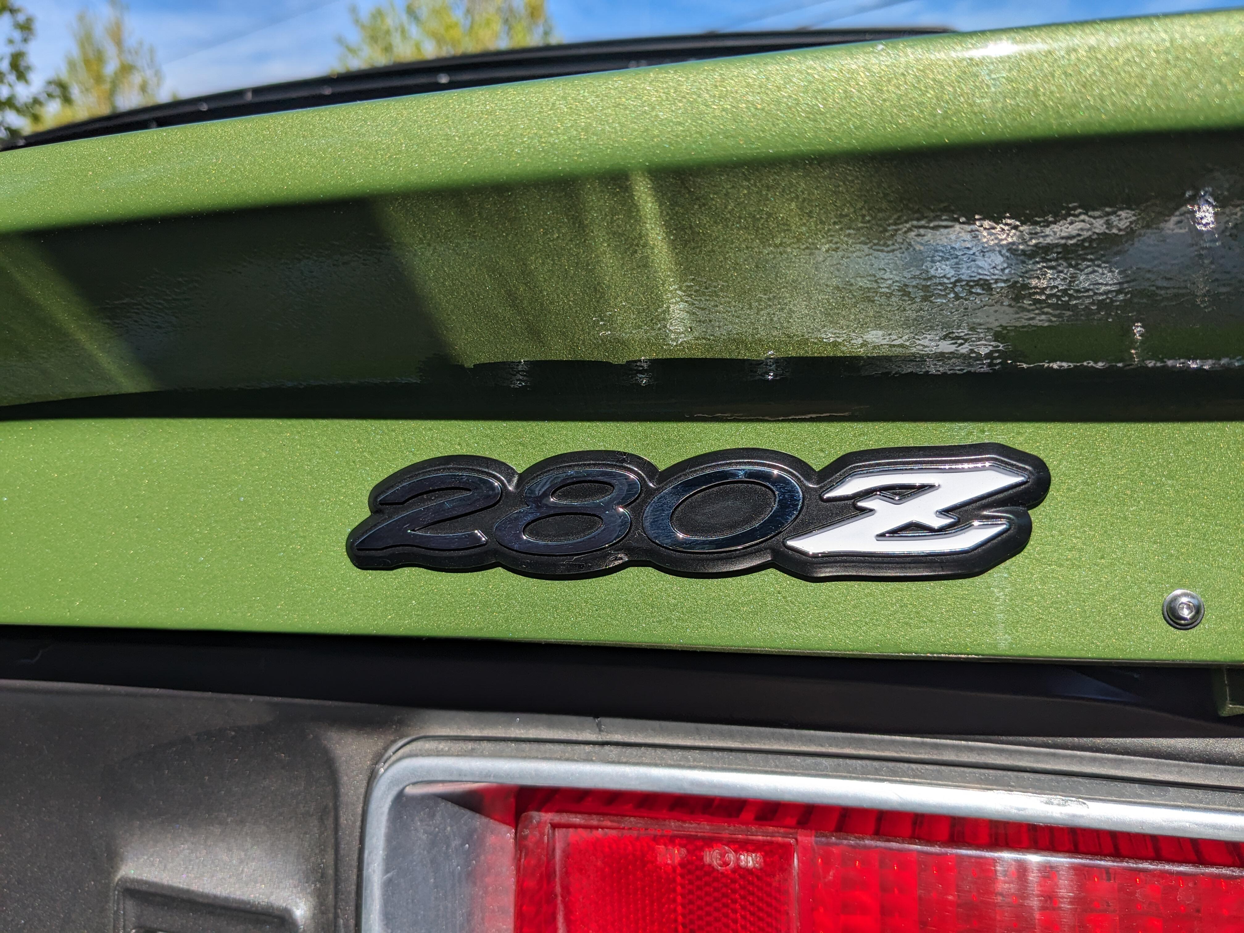

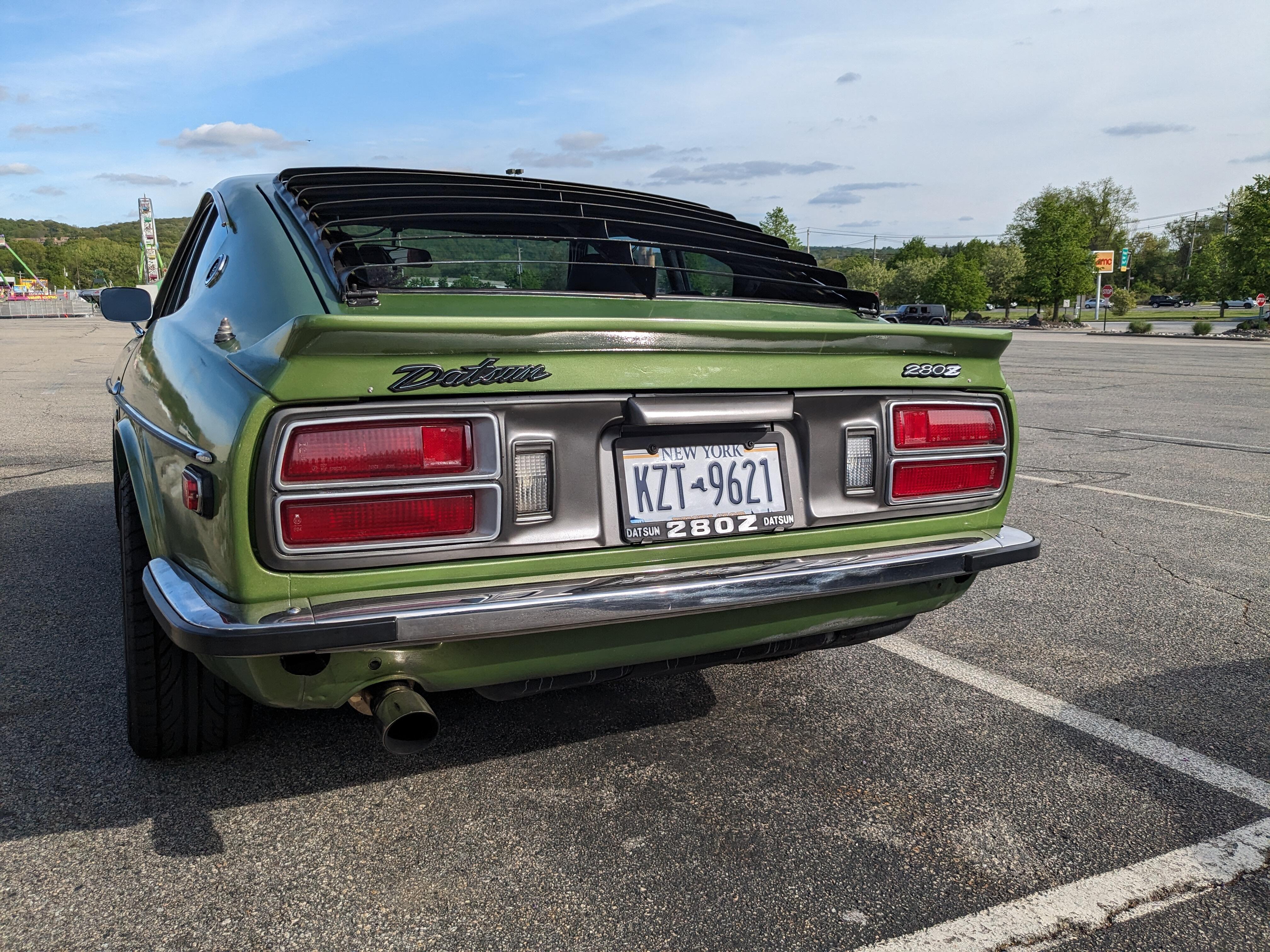

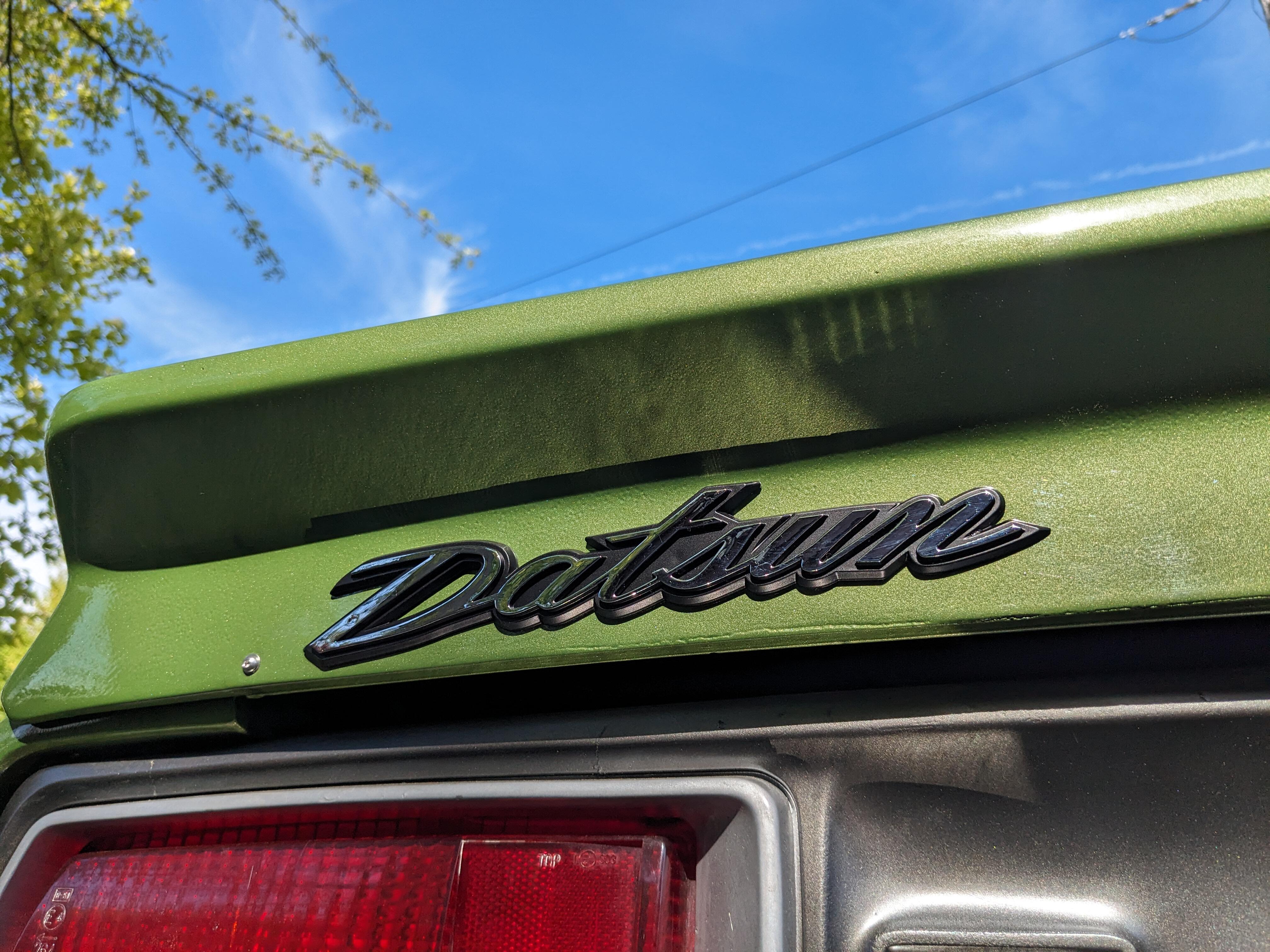

Got the new Datsun & 280Z emblems today (from resurrected classics). I contemplate the location of the Datsun emblem a bit, since on the hatch, it is set on a diagonal - it's obviously not really intended to be set in a horizontal spot. I ended up angling it very slightly to mimic the hatch fitting
280Z set horizontally, 15mm up from bottom edge
I just drilled the spoiler slightly under the pin size, so it's a press fit
27 minutes ago, SteveJ said:
There are little retaining clips you can put on the pins of the emblems to help hold them in place.
Hello Steve - I have them - they come with the new emblems - the spoiler is thicker than sheet metal, so I don't k now if the clips will lock into place. I didn't want to risk drilling what would then be an oversize hole in the spoiler & have the clip not work as intended.
