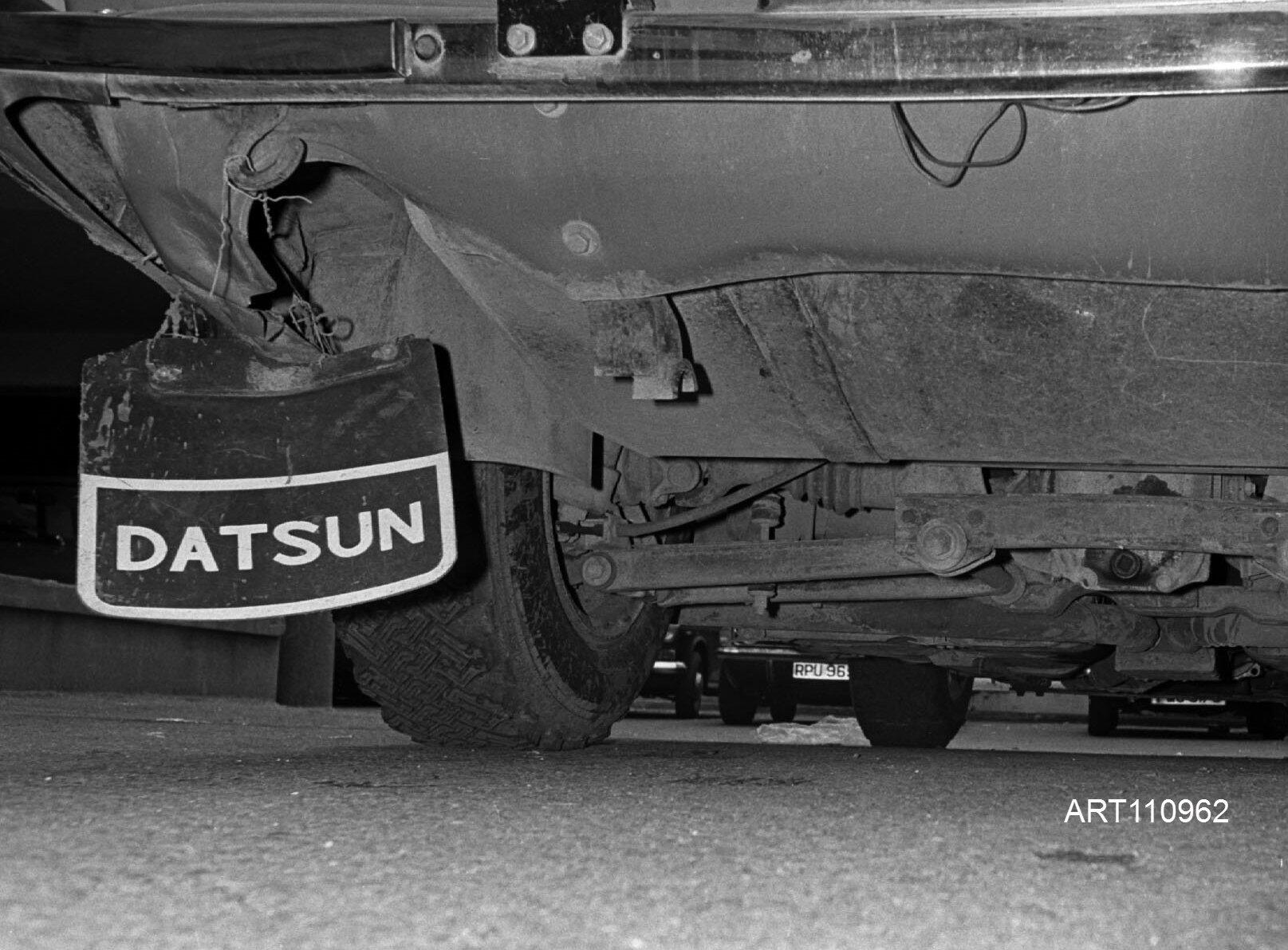

October 5, 20222 yr Author comment_646091 @Tweeds had a question about the mud flaps, so here is a little info on the evolution of the Works mud flaps. I've only included the early configurations that I know a little something about - I'd imagine there are other setups as well I'm not as familiar with. These are also not the greatest pictures, but they'll give some idea about the various styles the early cars employed. The first picture is 8D-420, an early test vehicle. Was this dual setup used in competition? it appears to be designed for serious gravel roads. The second picture is the early setup used through 1970 and 1971, which consisted of two outer metal straps, approximately 5/8" wide, bolted together and thru-bolted onto the car. These were accompanied by an inner, thicker metal bracket, which roughly held the mud flap in place, and could likely carry the weight by itself. I say "roughly", because there are several period photos showing the flaps having been moved backwards from their standard position during a rally stage. My guess is that the Works team were probably concerned about the mud flaps catching on something while driving, so they implemented a kind of outer "spring" system, that would give way, allowing the flap to move rearward, should it become entangled on a branch or rock. The third picture is from the 1972 Monte-Carlo car #5, and represents a later flap system employed for 1972, where the flap was more firmly fixed in place to the lower panel using a bracket. Edited October 5, 20222 yr by xs10shl Link to comment https://www.classiczcars.com/forums/topic/67572-1970-240z-works-rally-the-road-to-restoration/?&page=7#findComment-646091 Share on other sites More sharing options...
October 5, 20222 yr Author Popular Post comment_646092 986 used the early-style mud flap system. I received a set of period-correct mud flaps with the car in 2014, but no mounting hardware. So I set about scouring period photos for some details on how they were assembled. The setup I went with was my best guess, given the information at hand. Thankfully, the job was made easier by the simple fact that the mounting holes were clearly visible, making locating the flaps a breeze. I chose 5/8" galvanized strap material for my outer brackets. This strap appeared to be roughly the right thickness - it was wide enough to drill a 7mm hole through, which was a ballpark guess as to the approximate size of hardware used.  For the inner bracket, I chose a 1/8" thick steel bracket from Ace Hardware, which I bent into shape, making sure to leave the "Ace" stamp outward, for all to see! These materials were clearly not original, as I'd expect the real brackets to be made out of metric stock, but it served it's purpose for showing the car with the mud flaps in their approximate positions. I'll likely go over the choice of materials again during restoration, as I think I made the rear outer "spring-strap" slightly too short, giving it a "too straight" appearance. Also note that the right-side photo appears to have an extra hole by the bumper mount - my early assessment is that this is potentially just a random bumper mounting hole (or otherwise a hole used for other purposes, given it's size relative to the other bracket holes), as there is no corresponding hole on the left side. So I did not use it to mount the outer bracket. Instead, I hung the outer brackets by drilling a larger diameter hole in the strap, and affixed it between the bumper and body using the existing bumper bolt. I'm not yet 100% certain that this is the correct method, but it was close enough to make the flaps hang properly, so I went with it for the time being. Edited October 5, 20222 yr by xs10shl Link to comment https://www.classiczcars.com/forums/topic/67572-1970-240z-works-rally-the-road-to-restoration/?&page=7#findComment-646092 Share on other sites More sharing options...
October 12, 20222 yr Popular Post comment_646299 People might wonder why such effort was made with regard to mudflaps, and the answer is that many events mandated their use - for safety reasons as much as anything else. In events such as the Monte Carlo Rallye, where studded tyres would be used on the mountain stages, there was a very real risk to following vehicles. There were often penalties for cars which finished with damaged or missing equipment, so some teams added extra sets of mudflaps which were rolled up out of the way and could be deployed as replacements. If not, great efforts were made by the team to jury-rig a repair in the field. The old faithful of baling wire doing its stuff: Edited October 12, 20222 yr by HS30-H typo Link to comment https://www.classiczcars.com/forums/topic/67572-1970-240z-works-rally-the-road-to-restoration/?&page=7#findComment-646299 Share on other sites More sharing options...
October 15, 20222 yr Author comment_646418 @HS30-H great picture. Folks also can see the clever later exhaust routing, which added considerable ground clearance. In addition, something I had not noticed before on the earlier cars - a rear c-chaped bracket, which I assume is for one of those mobile jackstands? A device like that would only be possible with the re-routing of the exhaust. It's clearly very bent out of position, to the point where it's likely not usable, but it's mere presence may have saved the fuel tank from whatever the car backed into. Link to comment https://www.classiczcars.com/forums/topic/67572-1970-240z-works-rally-the-road-to-restoration/?&page=7#findComment-646418 Share on other sites More sharing options...
