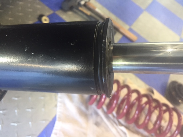

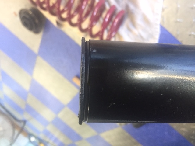

So I finally got around to disassembling one of my rear struts.  The gland nut hits the top of the strut cartridge and thus does not allow the gland nut to bottom out.  Also, inside the gland nut is a sleeve that is removable and pictured.  This is the gland nut that came with the KYB struts, the instructions that came with the struts was very generic and zero help.  Thanks for any suggestions.  I am hoping that this might be the root cause of my suspension noise when going over sharp bumps.
All of that is correct.  The nut is supposed to clamp the insert in to the strut tube.  The sleeve keeps the insert centered.
Your gland nut does look a little bit deep though.  When you tighten it down are you sure that it is actually clamping the top of the insert?  It might be bottoming out on the internal threads.  Tighten it down with the shock/insert inside then grab the shaft of the shock and see if it can be moved side to side or up and down.  You can put a washer on top to get more clamping if it's bottoming out on the internal threads.

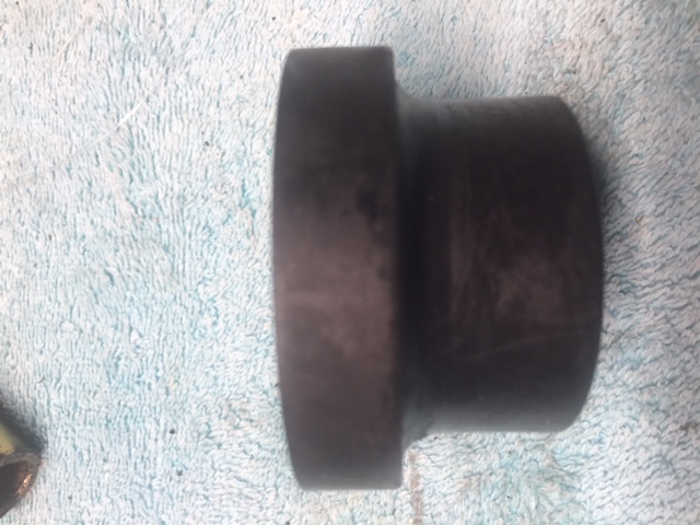

The clunk is gone...The new bushings are black and shiny, also notice the taper on the end of the bushing.  See the first pic.  The green stuff is a marine grease I used to keep the washer in place as I installed the bar.  The bushings were extremely tight, I had to shave a small amount of material to get them pressed into the bar.
  The old ones are Prothane, see second pic.  I purchased them in a kit from Zcardepot.  they are dullish and and have no taper.
