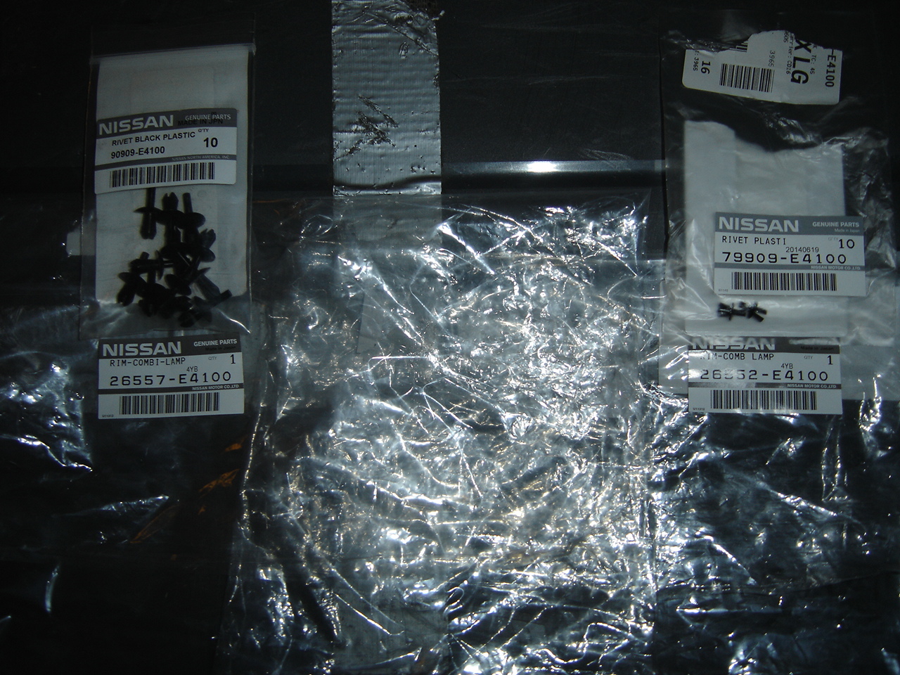

If you do it right and remove the rear finisher you'll need two different size push pins. The big ones on top and two smalls behind the tag. You may be able to reuse the old ones if you're careful and able to find the center pins. Those on top are hard to find.
I've got both style Nissan part numbers at home, if you need them let me know.

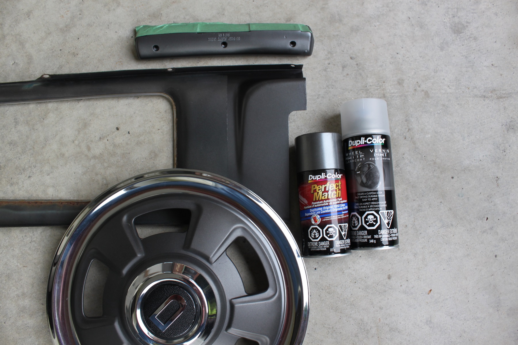

I made it back home and looked at my spray cans, it's Graphite by Dupli-Color and then I went over that with Matte clear.  They're both wheel paints.
Sorry about the mix up, hope I haven't caused any problems.

That's funny you mention that! I bet I sanded and painted that finisher panel 3 or 4 times until I was happy enough with it. Then when I sprayed the clear matte finish to knock the sheen down, it blended in and turned even better. The camera shows more reflection than in person. It really looks like a suede finish to me. I did the front grille the same way. Both cans were probably $15 or so. You need to tape off the stainless/chrome looking strip around it too.

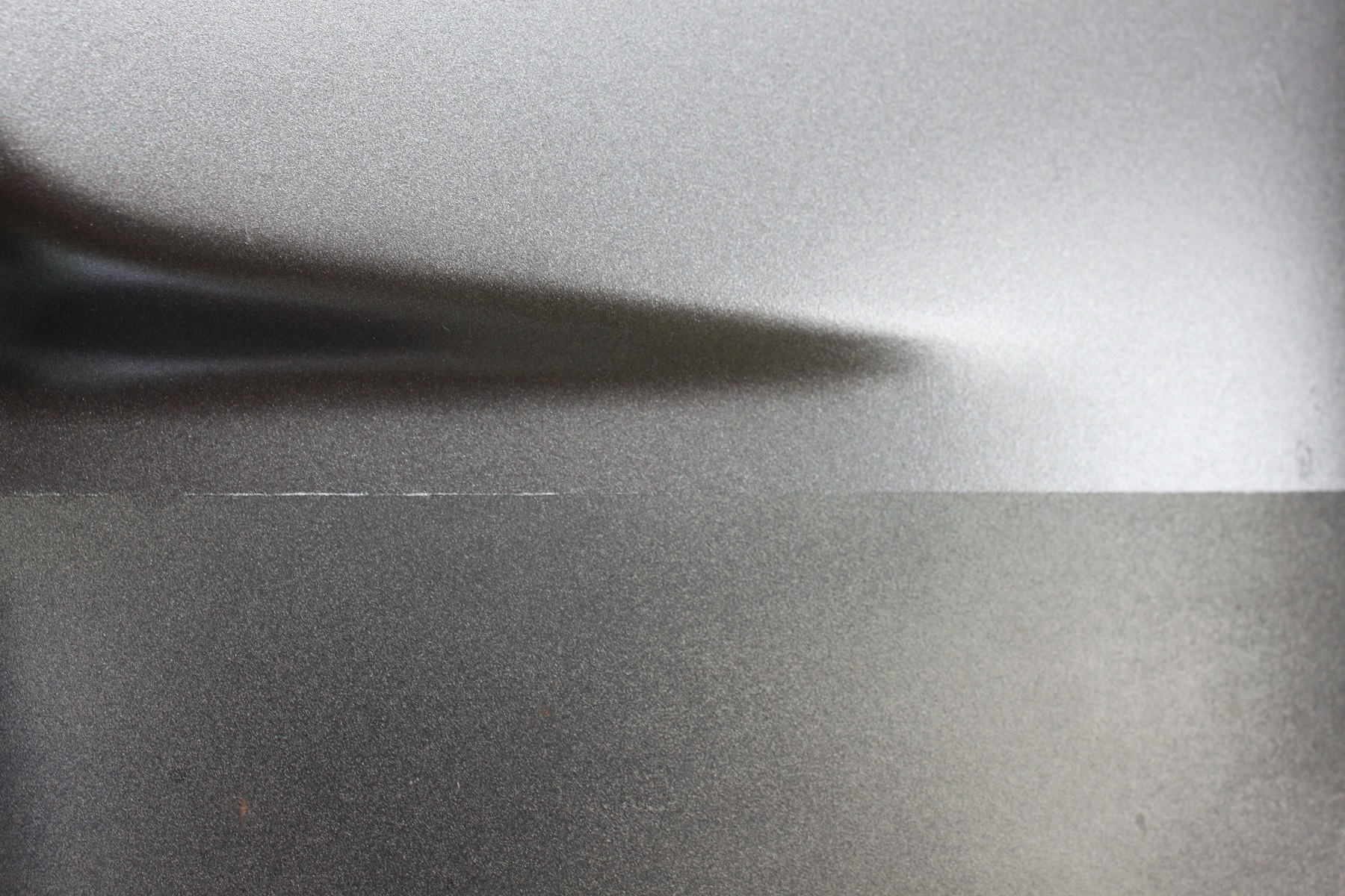

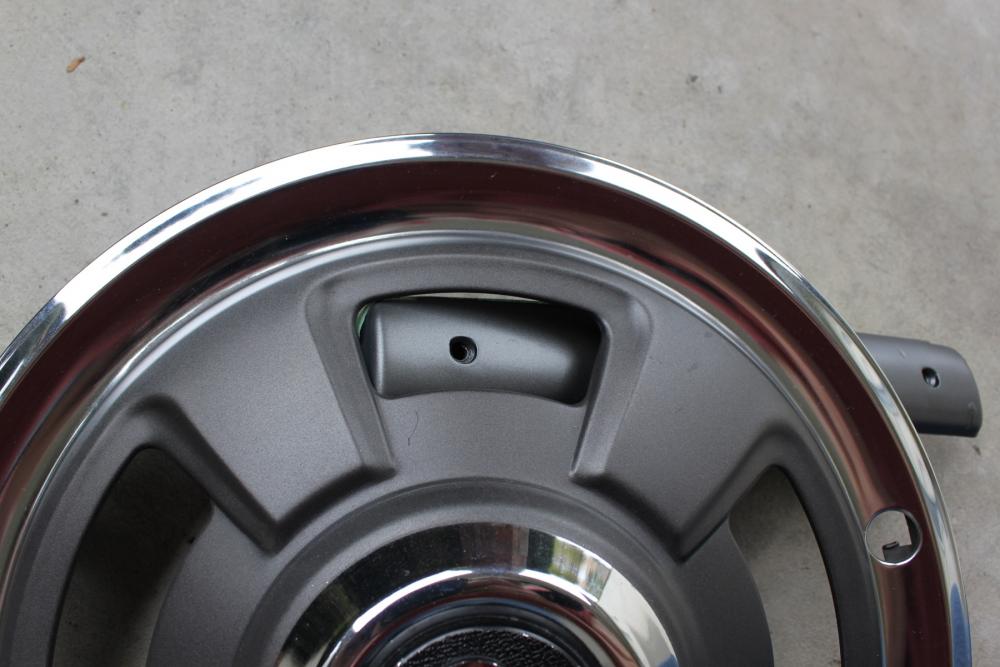

For a test I did a partial paint to the inside of a tail light finisher half from my 12/70 parts car that was the original grey.  I also did a test on a old license plate light body. I used two coats of paint and two coats of the Dupli-Color matte clear.  Here are the results comparing to one of my un-restored original hubcaps that are only brought out for shows.
Here is a close up showing the new paint at the top and the original paint at the bottom, I'm quite happy with the results. The paint not being metallic makes the job much more forgiving.
And here is the license plate light body with new paint compared to the un-restored hub cap:
