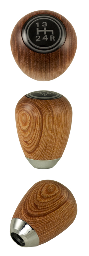

While I agree that the wood you used appears to be poplar, I believe the original knobs were a light walnut. Mine may just be a particularly light specimen.
See MSA's stock knob.
