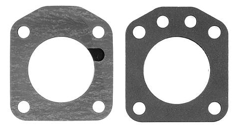

:cry: Okay, I braved this unusually cold Sunny Okanogan Valley day to get one of my new N36 manifold insulator/gaskets from NAPA. This one came in from Seattle, the other one won't be in until Tuesday, it's coming from Portland, OR. The NAPA part number for the narrower insulator they used on the 260Z manifold is NGAG30706. It can be found at:
http://www.napaonline.com/cgi-bin/ncommerce3/ExecMacro/NAPAonline/search_results_product_detail.d2w/report?prrfnbr=23486591&prmenbr=5806
They also looked up the insulator/gasket number (again) for the regular 240Z insulator/gasket for use with the 240Z manifolds. It is actually for the later 1972-1973 Carbs as it has four holes on the bottom of the insulator instead of just 2, for a total of six, rather than four. It is also pointed on the bottom side, rather than square, the extra holes are for the water cooled carbs (I think). This works fine with the earliest 240Z carbs '70-'71 and for the '72s, because the extra holes will just be covered over where not needed. Here's the listing for this insulator NGAG30694 on NAPA:
http://www.napaonline.com/cgi-bin/ncommerce3/ExecMacro/NAPAonline/search_results_product_detail.d2w/report?prrfnbr=23486580&prmenbr=5806
So to review:
260Z (N36) manifold used with early SU carbs: Part # NGAG30706
240Z (E88) manifold used with early SU carbs: Part # NGAG30694
The N36 insulator is alot narrower and should allow me to get the washer/lock washer/nut on without having to trouble of changing the studs to longer ones. I'll post pics of the two different insulators, they come with gaskets on both sides. Unfortunately NAPA site doesn't have pic that shows different thicknesses. When I fetch my UBS cable from work for my digital camera I'll try to post pics of the two types of insulators side by side, as well as before and after pics of them on the carbureators. I know this is a long reply, but I'm trying to get the info right. Now I just want some polished linkage and new nuts and screws on the carbs. Saw some stainless steel replacement screws (with Allen Heads) for the bells/pots (whatever they're called) once on ebay, should have bid. Went to my local Ace Hardware to look, but they're all outside (under big roofed/fenced-in garden center) in the wind chill and after 10 minutes looking thru they're minimal supply of metric stuff I bailed and bought some ear-muffs and mittens inside (they're also a dry goods/dept. store). In small towns most stores don't stay open all day Saturday so my choice was limited.
Hopes this helps (At 4 miles from the 49th Parallel) I'll talk to you all later, Gary
Somehow I can't get the right picture to show up, so I've deleted them from the last post and will try again. Here are the two insulators side by side.

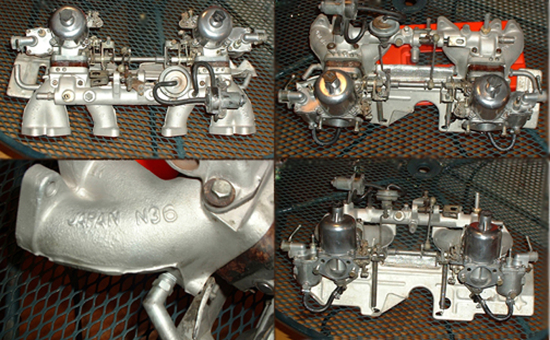

ROFL Here's a little Photoshop multi-image of my 70-71 SUs with the N36 intake. They still have the insulators designed for the earlier intakes. Consider this the "before" picture and I'll try and post the "after" view when I get them on. I want to replace all the bolts and screws with nicer ones and the vacuum thingy if I can, but don't know where to get. Otherwise I guess I'll just do a paint job. Gary
